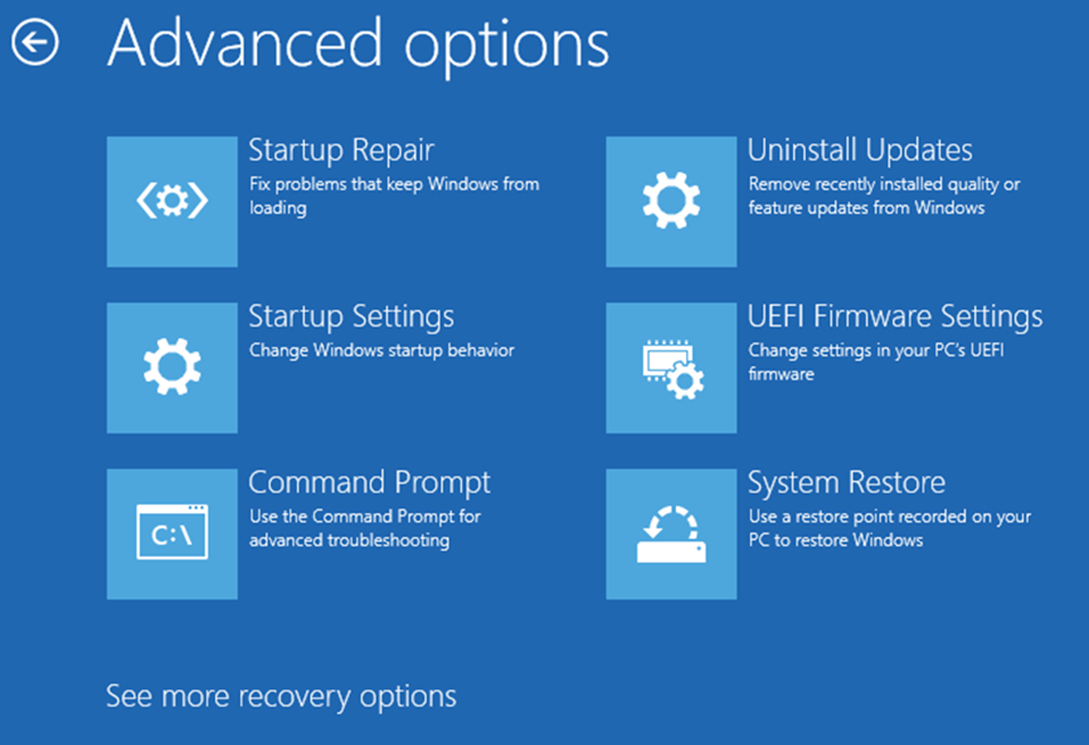

    7. Allow your device to restart into Automatic Repair and select Advanced Options to enter winRE.
    8. On the Choose an option screen, select Troubleshoot > Advanced options.
      0x000000e NCM3ojj5JWj19fiX3QInfotydW9pQPnBqE1IsrfyMcM8fEn26FGGUyMFy2sECUfVl9mze5otBSmJoZtBXFwh6ZPcJ5rRg%3d.png
    1. Choose "Startup Repair" to try the system automatic repair.
    2. Select "Command Prompt", then log in with your account, and run the commands below.
    3. If you installed the system update before the system is abnormal, you can use "Uninstall Updates" to uninstall recent updates (which include Quality updates and Feature updates, try both).
    If anything is unclear, please do not hesitate to let me know.
