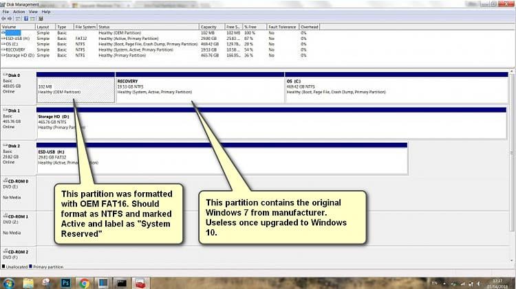

  3. topgundcp Win User
    Upgrade Windows 7 to 10 Error 0x8007001f
    0x8007001f error upgrading windows 10 to windows 11 upgrade  fails 183140d1522615083t-upgrade-windows-7-10-error-0x8007001f-disk-management.jpg
    The partition layout of disk 0 (shown as disk 1 in Partition Manager) is non standard and was customized by the manufacturer. A normal Win 7 installation will have a layout:
    1. 100MB System Reserved, NTFS format and marked as Active
    2. C drive.
    A normal Windows 10 installation will have:
    1. 550MB Reserved partition, NTFS format and marked as Active
    2. C drive.
    Since you know how to use Minitool Partition Manager. Suggest to use it:
    1. Create a bootable installation USB from the Windows ISO using: Rufus - Create bootable USB drives the easy way
    2. Delete the 1st 2 partitions (102MB, 15GB) then create a 550MB partition, format as NTFS, label "System Reserved", assign a letter R, mark as Active
    3. Move C drive next to the newly created 550MB. should look like the screen shot below, note H: drive should be C: in your case:
      0x8007001f error upgrading windows 10 to windows 11 upgrade  fails 183142d1522615995t-upgrade-windows-7-10-error-0x8007001f-p2.jpg
    4. Boot up the USB created in step 1, on the first screen, press SHIFT+F10 to open the Admin command prompt then type:
      bcdboot C:\Windows /s R: /f BIOS =====> This will create the BCD to boot Windows and store in R: (550MB partition)
    5. Reboot the PC then try to upgrade again
    NOTE: It is advisable to create a backup image of the whole disk 0, just in case anything goes wrong then you can restore back before making any modification.

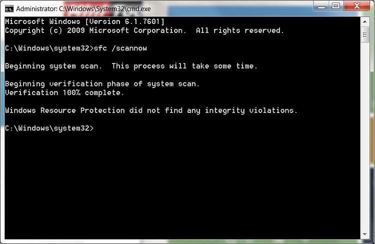

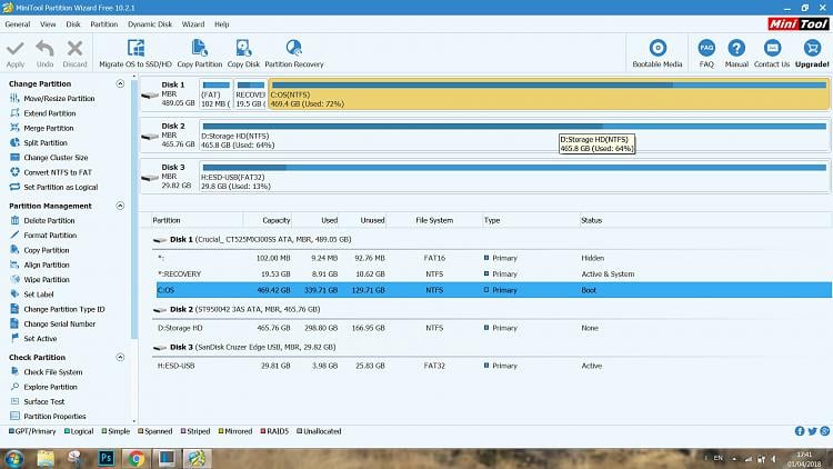

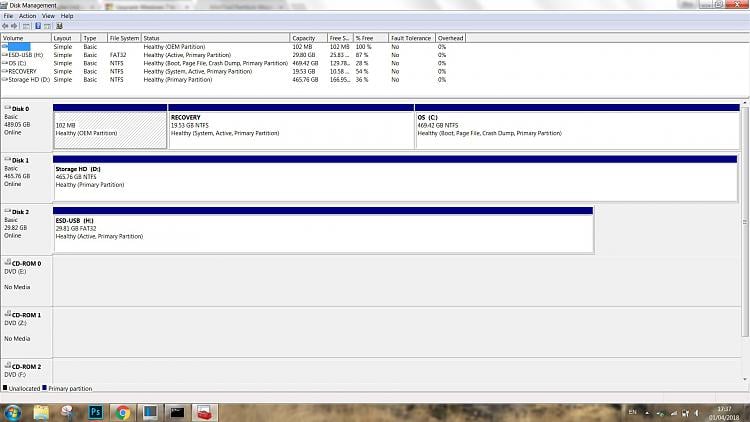

  4. ned14 Win User
    Screenshots of partitions and sfc/scannow results.
    0x8007001f error upgrading windows 10 to windows 11 upgrade  fails 183122d1522600959t-upgrade-windows-7-10-error-0x8007001f-disk-management.jpg
    0x8007001f error upgrading windows 10 to windows 11 upgrade  fails 183123d1522600959t-upgrade-windows-7-10-error-0x8007001f-minitool.jpg
    0x8007001f error upgrading windows 10 to windows 11 upgrade  fails 183124d1522600959t-upgrade-windows-7-10-error-0x8007001f-scannow.jpg
    ned14, Jun 1, 2024
