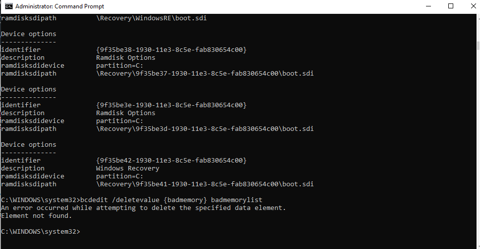

  3. error 0xc0000017
    while trying to reset my laptop , in the restart phase , i get this error 0xc0000017
    according to a previous post , I tried to solve this problem using these commands
    1. Go to the to search field at the bottom left and type Command Prompt.
    2. Select Command Prompt.
    3. Type bcdedit /enum all and press Enter.
    4. A list of all memory locations labeled as "bad" will appear. This list can be removed or deleted.
    5. You need to type bcdedit /deletevalue {badmemory} badmemorylist and hit enter. Please type the command accordingly.
    6. Then you can exit and and restart your PC and perform the update.
    and i get this error.
    0xc0000017 BSOD when trying to reset my PC 69035401-cc04-4a64-abda-a235894a39c5?upload=true.png
    is there any solution?
