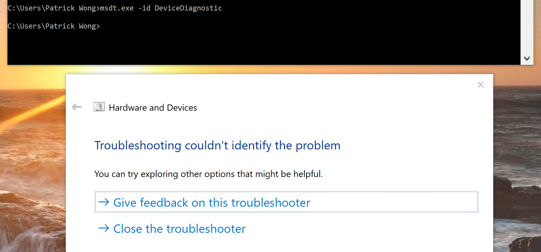

    I have tried every fix for this:
    • The troubleshooter can't find the issue
    20H2 update causes "Unknown USB Device Device Descriptor Request Failed" 870f9956-d9cf-4233-9d7b-a2069e8dd525?upload=true.png
    • Deleting all the drivers under "Universal Serial Bus controllers" in Device manager and then restarting my laptop does not work.
    • Looking for an update in Device Manager for the "Unknown USB Device" does not work.
    • Disabling fast startup does not work
    • Changing the USB selective suspend settings do not work
    Anything else I can do?
