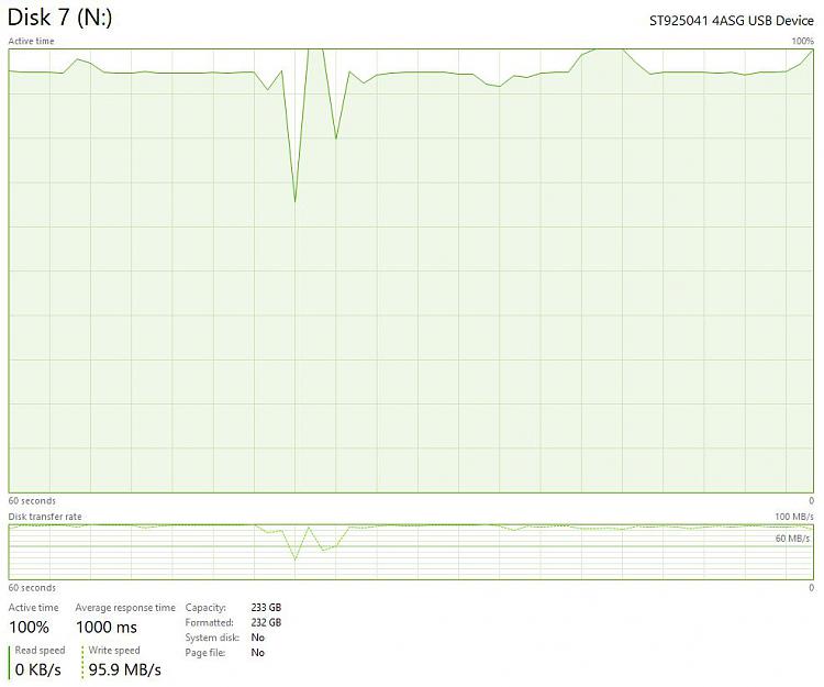

  4. Cr00zng Win User
    2ed and 3rd usb port keep connecting and disconnecting every second
    System connects and disconnects USB drives...
    Thanks Bree, but doing so made no difference.
    I've been researching this issue, including event ID 51. Most seems to suggest that the drive is failing, but that isn't for my drive. The USB 3.0 hub on the monitor does not have the system connect/disconnect issue, transferring 11 GBs of data didn't even take long:
    2ed and 3rd usb port keep connecting and disconnecting every second 197212d1532615677t-system-connects-disconnects-usb-drives-usb_hdd.jpg
    The most helpful advice had been this one:
    USB port mess... - Windows 7 Help Forums
    Yes, my own post from four years ego in Windows 7 forum, pretty much forgot that the Gigabyte GA-Z77X-UP5 TH motherboard has a hardware issue related to the USB ports.
    Maybe removing all USB hubs/devices, let Windows 10 detect them and install the driver(s) would resolve this. After reading through my link above, I am not inclined to do that at this time...
    Again, thanks for your help Bree...
    Cr00zng, Jul 6, 2024
