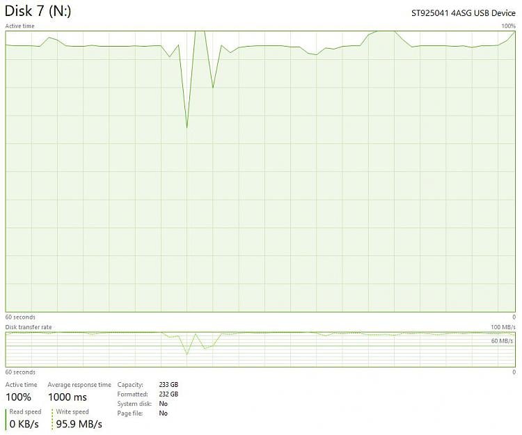

    System connects and disconnects USB drives...
    Thanks Bree, but doing so made no difference.
    I've been researching this issue, including event ID 51. Most seems to suggest that the drive is failing, but that isn't for my drive. The USB 3.0 hub on the monitor does not have the system connect/disconnect issue, transferring 11 GBs of data didn't even take long:
    2ed and 3rd usb port keep connecting and disconnecting every second 197212d1532615677t-system-connects-disconnects-usb-drives-usb_hdd.jpg
