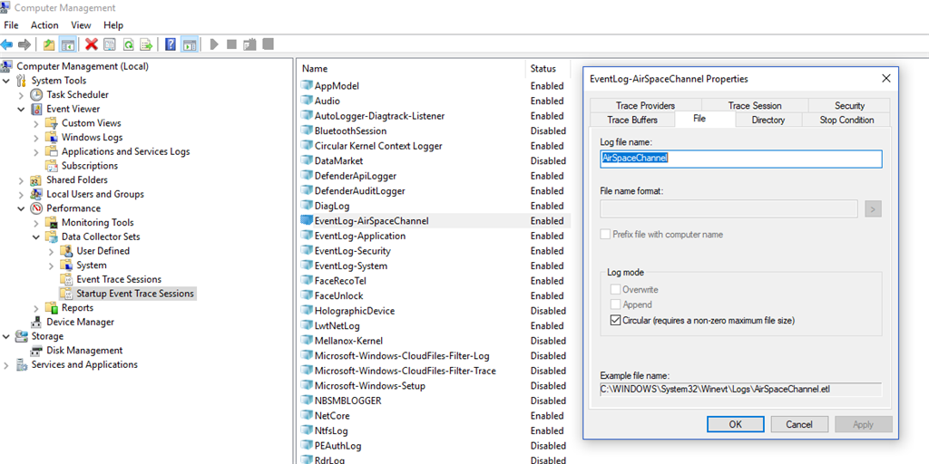

    BSOD: session "eventlog-airspacechannel" stopped due to the following error: 0xc0000188
    My PC went to sleep mode after 10 min and woke up while crashing
    (BSOD) and creating a memory dump.
    I could trace the crash to this event : session "eventlog-airspacechannel" stopped due to the following error: 0xc0000188.
    It seems to be related to an eventlog as set by the Performance monitor (see this
    The fix suggested in that post, is to set the Log mode to "circular"(see picture)
    4 reoccurring event logs leading into windows 11 crashing. volmgr, Eventlog, EventLog, Tcpip 184c61ab-2aa8-46c3-9dfc-75236d63be47.png
    My questions are:
    • How can an event log crash my system?
    • Why do I need to log this event in the first place? Can I disable it?
    My specs: Windows 10 pro 64-bit version 1703 (build 15063.250) with Office 2010.
