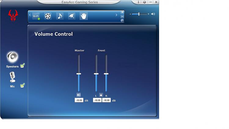

    These headphones from Amazon (see Link) are supposed to have 7.1 virtual surround sound. It only shows as a stereo device in Windows 10 (build 18363.535)
    It is a model EasyAcc G941 (or EasyAcc 7.1 Virtual Surround Sound USB Gaming Headphones).
    5.1 surround sound system showing up as headphones 260140d1576984894t-no-virtual-surround-new-headphone-amazon-driver.png.jpg
    only Stereo (EasyAcc Driver)
    5.1 surround sound system showing up as headphones 260141d1576984894t-no-virtual-surround-new-headphone-amazon-software01.png

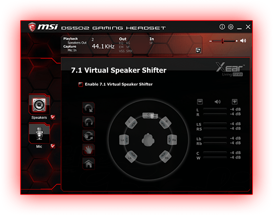

    7.1 (here MSI DS502 driver stock photo)
    I have since found out it is sold under a variety of brands. For instance: MSI DS502 and by SADES.

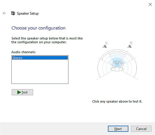

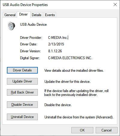

    I tried installing all these drivers (and of course the EasyAcc driver) and they are identical except for the brand logo. The driver is always a C-Media driver with version 8.1.12.26 and a driver date from 2015. All the controls are locked down or invisible except for stereo left/right volume control. In Windows 10, it shows as a stereo device in control panel.
    5.1 surround sound system showing up as headphones 260142d1576985713t-no-virtual-surround-new-headphone-amazon-control-panel-stereo.png.jpg
    control panel
    5.1 surround sound system showing up as headphones 260143d1576985843t-no-virtual-surround-new-headphone-amazon-driver-device-manager.png.jpg
    device manager
    How can I make this work with 7.1 surround sound?

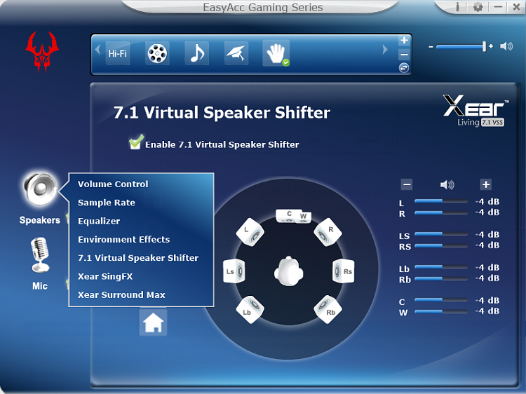

    Update: I've found the missing controls:
    5.1 surround sound system showing up as headphones 260196d1577016510t-no-virtual-surround-new-headphone-amazon-7.1.png
    Needed to right click the speaker symbol. So, completely counter intuitive. Like so many apps from Asian hardware manufacturers. Reminds me of my GeForce over-clocking tool.
    However now it still registers in Windows as a stereo device. How can any app or game output to it in 7.1? I don't think it can.
    I guess my question now is: Any headphones with virtual surround should register in Windows as a 5.1 or 7.1 device. Is this correct?
