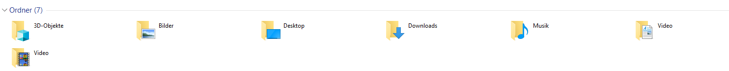

    Hey guys,
    I tried to reorganice my computer and made a mess. I wanted to switch my user folders pictures, videos, musik & documents from my SSD C: to my HDD D:. But now, the document and the video folder are the same. If I cange the path of one of those it´s the same for the other one, and it´s the same if I cange the name of one of those.
    accidentally combined 2 user folders video & documents 0fd9dbdb-47a7-4109-8305-2d288be1769c?upload=true.png Maybe it´s connected to the fact that I made a mistake and used the whole D: as my document folder. But for picture and music I could "repair" everything. Therefore I don´t know what to do.
    Thanks for ur help.

  2. Downloads folder is the Documents folder
    Hi Chris,
    I suggest you to Restore to Default the folders and document settings and see if it helps.
    Step 1:
    Please follow below steps and check if it helps.
    • Go to Download folder.
    • Right click on the Download Folder and go to Properties.
    • In Properties go to Location tab.
    • In location Tab Click on Restore Default.
    Step 2:
    • Go to Documents folder.
    • Right click on the Document folder and go to Properties.
    After performing above steps change the settings as you required and check if it helps.
    Hope these information helps, please get back to us for future support, we’ll be glad to assist you further.
