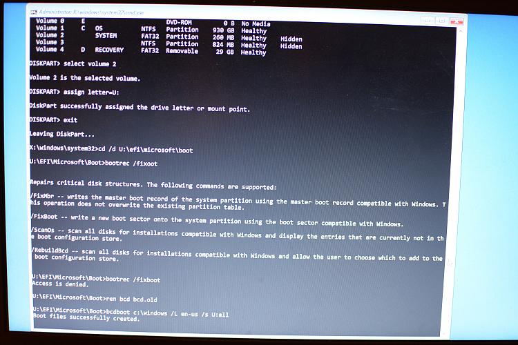

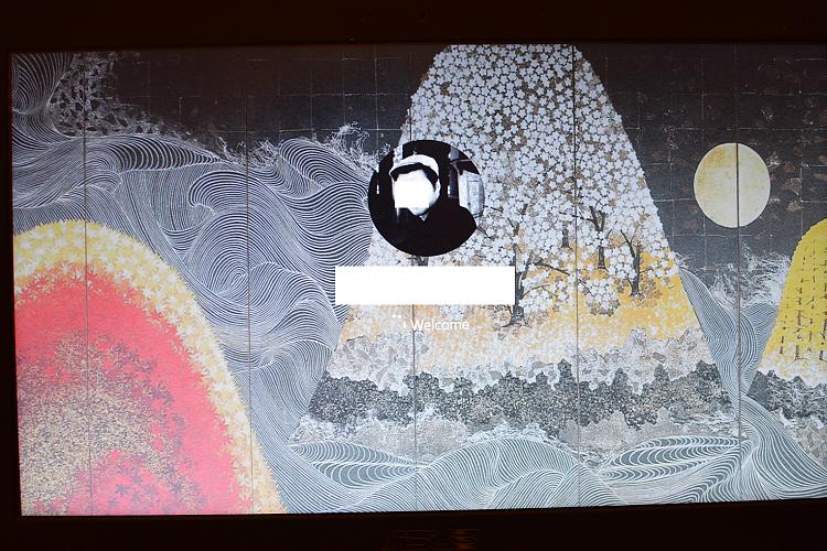

  4. Acpi driver update caused my boot device on my ssd to give an INACCESIBLE_BOOT_DEVICE error
    Repeated Crashes and Boot Errors Apparently Caused by Driver Updates
    I got as far as step 13 and... it booted to desktop! I assume I should go on and enter the remaining commands into administrative command prompt?
    Acpi driver update caused my boot device on my ssd to give an INACCESIBLE_BOOT_DEVICE error 181089d1521218210t-repeated-crashes-boot-errors-apparently-caused-driver-updates-dsc_9578.jpg
    Acpi driver update caused my boot device on my ssd to give an INACCESIBLE_BOOT_DEVICE error 181090d1521218210t-repeated-crashes-boot-errors-apparently-caused-driver-updates-dsc_9579.jpg
    Borromaeus, Aug 3, 2024
