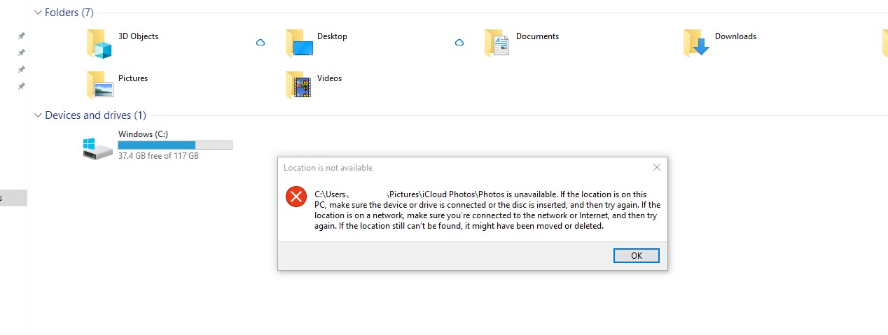

    Hi. I'm having a problem removing a deleted file from my quick access. I recently installed iCloud on my computer, then decided I didn't really need it so I uninstalled it. The problem is, the file still remains. In a screenshot which I have attached to this question, it will show the pop up message I received. I know this question came up somewhere else, but perhaps you can make an exception? I don't have very good computer smarts and for risk of doing something really dumb to my computer, please help me. I have tried everything. Thank you. Action won't allow me to remove deleted iCloud Photos file from quick access c21e540b-314c-43ff-8a99-f1c945f3c0a8?upload=true.jpg

  2. Remove iCloud Photos from Devices and Drives View in File Explorer
    thank you for this soln gogreen, much appreciated! Here is a quick summary for others if interested -
    Reference:
    Steps:
    1. Open regedit (Win+R, "regedit")
    2. Enter key in address bar
    3. Deprecate key
      • Opt A. - delete
      • Opt B. - rename something different (e.g. prefix with "_")
    4. Close and re-open to observe result
    Key:
    • HKEY_LOCAL_MACHINE\SOFTWARE\Microsoft\Windows\CurrentVersion\Explorer\MyComputer\NameSpace\{F0D63F85-37EC-4097-B30D-61B4A8917118}
    thanks! Action won't allow me to remove deleted iCloud Photos file from quick access :)
    justinmreina, Feb 12, 2021
