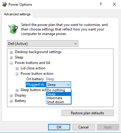

    Windows 10 Home Power Options "Turn off the Display" Power Button Not Available / Not Listed
    Hi guys,
    I've recently purchased a Dell XPS 15 (9570) and a feature I am very fond of under Power Options is not available on this machine.
    On my older machine (Dell M3800) I set the Power Button to "Turn off the Display", which helps save power and improves privacy when I step away from the computer without putting it to sleep.
    This machine on the other hand, does not list "Turn off the Display" as an option under the Power Button dropdown.
    See screen-grab below.
    Add or Remove 'Turn off Display after' in Power Options in Windows 22770e66-78c4-470e-9368-7a6c39f16ce3?upload=true.png
    I've checked if it is the Dell power plan that restricts this, but the "Balanced" one has the same list of options.
    The machine is running Windows 10 Home 1803
    Any help would be greatly appreciated, as Dell forums so far have been reluctant to accept that this is indeed a feature.
    KastytisDonauskis, Oct 26, 2019
