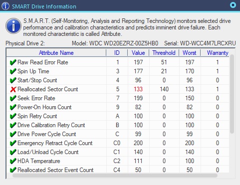

  4. Manosman Win User
    After firmware update, my D: drive disappeared
    D: Drive Suddenly Disappeared
    I have seen this command before, though I've never used it much, other than to list the disks. I indeed only have 1 2TB drive. However, it's gone again. And even though I tried to list the disks, only C: appeared.
    I'll try to open the box tomorrow and see if I can make it appear again.
    - - - Updated - - -
    So, I did a diskpart and then I was able to use the drive again, format it and it's now the same way I bought it (software-wise at least). I also made sure all drivers were up to date (just in case).
    However, when it comes to Western Digital's disk test, it still fails for the same reasons. The disk is currently empty, so it's indeed a hardware problem. The cables are all good, so it's the drive itself I guess.
    Any other suggestions maybe?
    - - - Updated - - -
    So, I did got no different results from the test, but I saw this. It seems this is the only fail it gives in this results window.
    After firmware update, my D: drive disappeared 283008d1591976645t-d-drive-suddenly-disappeared-untitled.jpg
    Manosman, Jan 17, 2024
