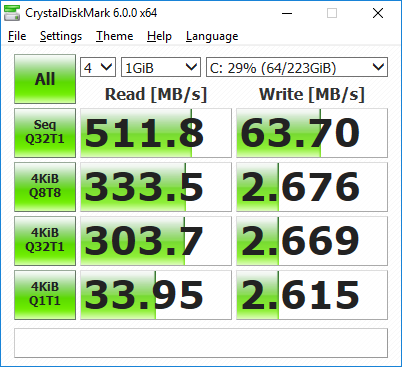

    How can I get my SSDs write speeds to perform normally?
    TL;DR My SSDs have read speeds in excess of 500mb/s in CrystalDiskMark, but have write speeds of 60mb/s and 200mb/s (Kingston and Samsung SSD, respectively). How can I get my write speeds to perform at their rated speeds (around 500mb/s for both SSDs)?
    All the information: I recently made a new PC build of the following components:
    I am running Windows 10
    The SSD in this new system was a re-used SSD from my old system - it's just over 1 year old. In my old system, it had fairly normal read/write speeds of around 500/400mb/s (respectively). However, in this new system, the read speeds perform fine, but the write speeds tank to around 60mb/s. All of these speeds I've mentioned are sequential tests from CrystalDiskMark. The stats get even worse in random performance, with random writes being around 2.5mb/s for every random write test in CrystalDiskMark. Here's an overview of the results:

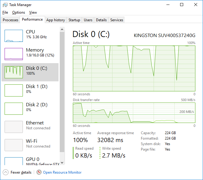

    The read performance seen seems pretty standard, the writes not so much. I also noticed during writes, the processing time for the drive in task manager tanks to 100% and over 30 second processing times. Reads, this doesn't happen and processing times stay under 100ms even in the worst cases.
    After installing window 11 my SSD is under performing. Sequential write speed is just... Ck4ID.png
    This is not a thermals related issue, as thermals in my system are fairly nominal (34c mainboard, 32c SSD temp, 30c CPU idle, 52c CPU load). What makes it even more confusing is the other drives in my system, the 2x 500GB Barracudas, are in a RAID 0 together and have solid performance of around 220/200 read/write (sequential). They don't experience any of the performance degradation in writes that the SSD did, and don't have the crazy processing times.

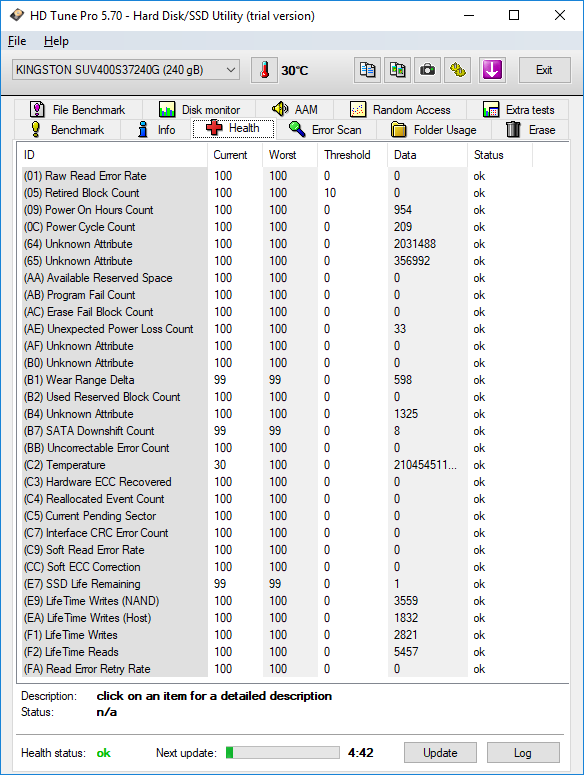

    For those that would like to see the SMART information for the Kingston drive:
    After installing window 11 my SSD is under performing. Sequential write speed is just... sf2ys.png
