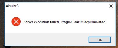

    I was investigating audio dropouts problem i recently had. They suggested:
    Update bios, motherboard chipset drivers, utilities etc
    Observe with app called latencyMon.
    Disable hyper threading on the bios
    Adjust windows energy saving mode to best performance
    Disable onboard audio card and disable windows sounds
    Disable many windows unnecessary process running at the background
    Sample bit rate could cause dropouts, adjust it to higher values like 256 to 512 or to 1024
    After let go the latencyMon app for an hour I've find out actually Nvidia card and it's drivers was number one suspect, secondly network related issues.
    Updated the latest bios, disable hyper threading, still dropouts
    Couldn't update the Intel chipset drivers because i had newer version
    Updated LAN drivers, still dropouts
    Installed utility called AI Suite 3 for the "issue that resulted in the Windows power plan being forced to [balanced]"
    Applied all modification for free windows, still dropouts
    I realized i remove the NVidia Card but drivers was still in there. I uninstalled and problem solved. I get back to work
    Then Windows update hit me.
    At first; that utility called "AI Suite 3", the gui always hanging on the right bottom corner of my desktop looked weird. I don't know what went wrong. Then every time i turn on my computer after few minutes i will have warning
    "Airsuite3"
    Server Execution failed, ProgID:0 "aaHM.acpiHmData2"
    message, then after few minutes all sound will go. I can see my sound interface has power and i can get sound from it because it has connected to my external tone generator, so if i hit my device it will send audio to my interface and i can hear.
    Next day i got back to my sound i thought its ok now, but no... After some time sound will cut, like now
    ASUS Z97-A ATX DDR3 2600 LGA 1150
    Intel Core i7-4790K Processor (8M Cache, up to 4.40 GHz) (BX80646I74790K)
    16GB G.Skill DDR3 PC3-19200 2400MHz Trident X Series CL10 (10-12-12-31) Dual Channel kit
    Samsung 840 Pro Series 2.5-Inch 512 SATA_6_0_gb Solid State Drive MZ-7PD512BW
    Focusrite Scarlett 18i8 USB second gen
    Windows 10 64 bit
