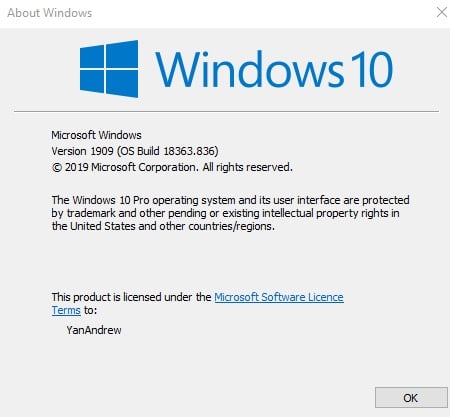

    My device information:

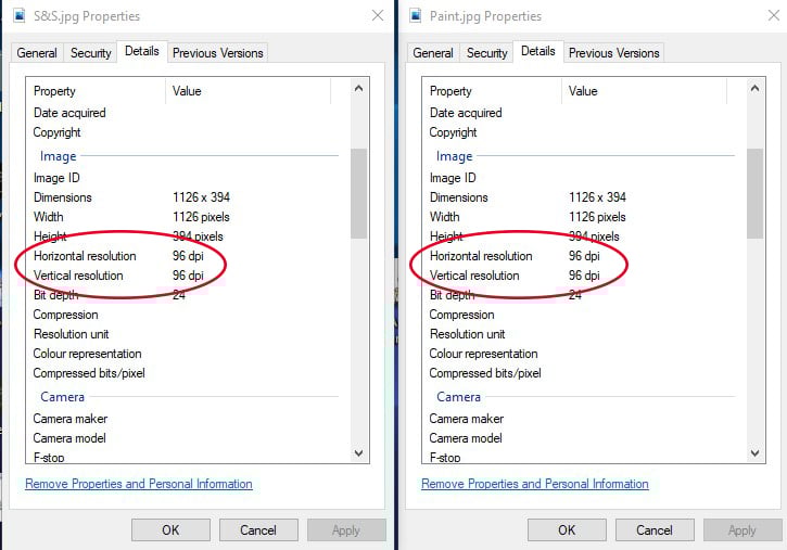

    Do you Guys know how to go about increasing the resolution of images taken using the Snipping Tool and / or the Snip & Sketch tool? The default resolution setting for both app is way too low (at 96DPI only) The image below shows the Properties window for an image taken with the Snipping Tool as well as the Snip & Sketch tool. As you can see, it's too low, I would like to increase it.
    After using the snip tool and clicking the image that pops up in the taskbar, the Sketch... 281321d1591009270t-snipping-tool-snip-sketch-resolutions-image-resolution.jpg
    Any help / guidance would be greatly appreciated.
