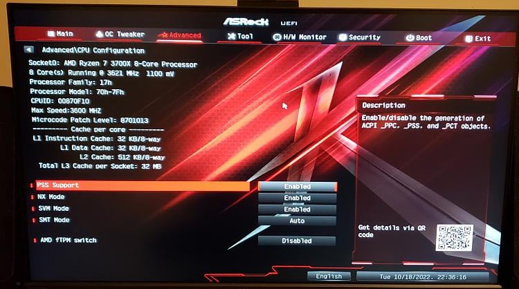

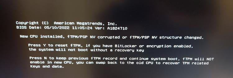

    Using Win 10 Pro, not sure which exact build. Not sure if this is directly related to Windows 10 itself or hardware related, but hoping I can get some insight into it to trouble shoot, Upgraded my CPU but received this error during boot:
    After Windows update received ftPM Message but this is not a new CPU, how should I move... d1666227275t-new-cpuinstalled-ftpm-nv-corrupted-error-after-new-cpu-install-20221019_172503-copy.jpg
    New CPU installed, fTPM/PSP NV corrupted or fTPM/PSP NV structure changed. Updated my motherboard BIOS last night (worked fine, booted fine), popped in the new CPU today. This is the 3rd CPU upgrade on this PC (1600 to 2700x to 3700x to new 5700x) and I've never seen this issue before. OS is Win 10 Pro. Motherboard is AS Rock X370 Killer SLI/AC. Current BIOS is 7.10. Motherboard: ASRock > X370 Killer SLI/ac Before updating the BIOS I checked to see if Bitlocker was enabled within Win 10, and it showed it was not enabled as far as I could tell. Before updating the BIOS, I checked fTPM settings that I could find within the BIOS. I found AMD fTPM Switch which was disabled. Old BIOS settings which I assume meant fTPM was disabled:
    After Windows update received ftPM Message but this is not a new CPU, how should I move... d1666227091t-new-cpuinstalled-ftpm-nv-corrupted-error-after-new-cpu-install-20221018_223616-copy.jpg
    I can boot into the BIOS settings, but I just clicked exit without saving. So I am wondering how I should proceed and what exactly is happening here? Perhaps the new BIOS enabled some fTPM setting after I upgraded, but I recall checking that beforehand and everything that looked like it was related to fTPM was disabled. I do have the old CPU that I can put back in, but would like to solve this so I can use the new 5700X. Does this look like a hardware or issue or Win 10 issue? Edit: Figured out the issue. Went into BIOS, Advanced, Trusted Computing, Security Device Support - Disable. Booted into Windows just fine now, so looks like it was a motherboard settings issue and not Windows. Going to close this thread if possible but leave it up in case someone else the same issue.
