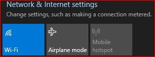

    I, as other IT managers for schools have been chasing our tails to DISABLE the Airplane Mode button as shown below:
    Airplane Mode is on and button is gray. Clicking on button does not work 290506d1596219595t-how-disable-airplane-mode-button-capture.jpg
    I have been able to DISABLE the Mobile Hotspot button by using:
    Code:
    Has anyone looked at this lately? Does anyone have a suggestion?
    The solution needs to be a registry tweak, as I do not want to access each computer individually.
    Many Thanks...
