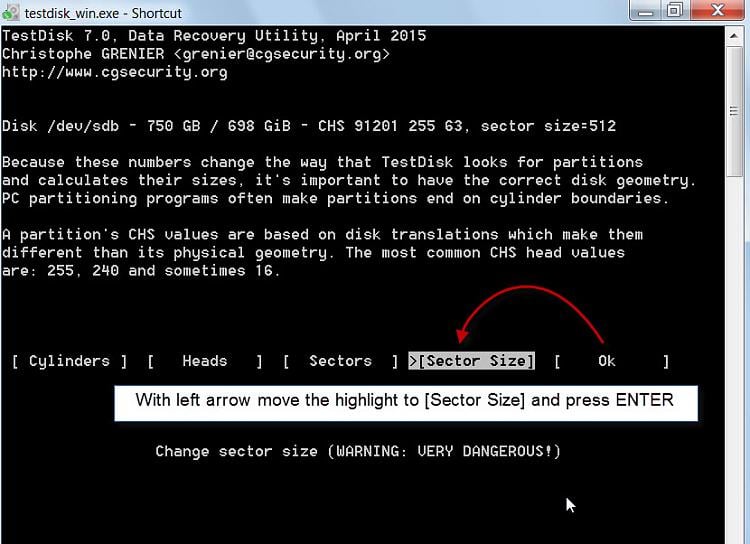

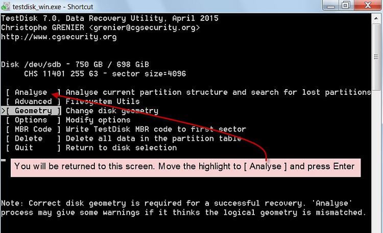

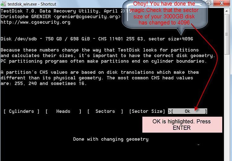

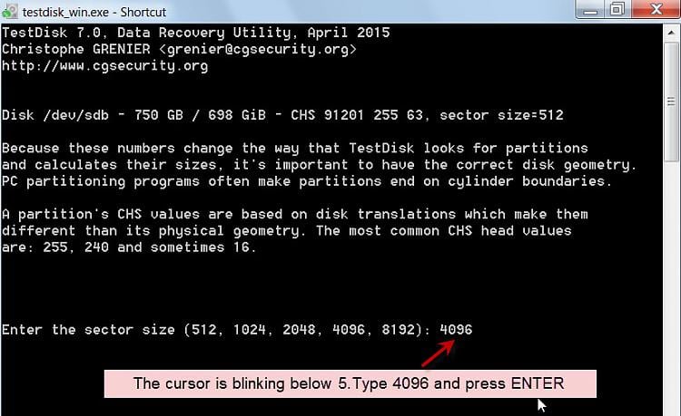

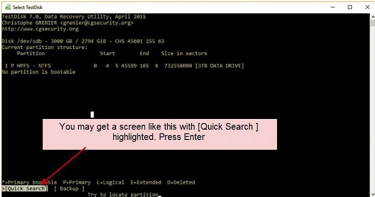

    Note: The disk I am using for the screenshots is 750GB. Your source disk should show as 3000GB with sector size = 512 which we will be changing to 4096.
    On the fifth screen you posted
    All external storage USB, HDD suddenly becomes readonly, cannot delete files, need... 190790d1527833433t-external-hdd-visable-but-suddenly-gone-unreadable-a01-06-2018-08-01-47.jpg
    All external storage USB, HDD suddenly becomes readonly, cannot delete files, need... 190791d1527833497t-external-hdd-visable-but-suddenly-gone-unreadable-b01-06-2018-08-44-49.jpg
    All external storage USB, HDD suddenly becomes readonly, cannot delete files, need... 190792d1527833497t-external-hdd-visable-but-suddenly-gone-unreadable-c01-06-2018-09-03-49.jpg
    All external storage USB, HDD suddenly becomes readonly, cannot delete files, need... 190793d1527833497t-external-hdd-visable-but-suddenly-gone-unreadable-d01-06-2018-09-44-15.jpg
    All external storage USB, HDD suddenly becomes readonly, cannot delete files, need... 190794d1527833497t-external-hdd-visable-but-suddenly-gone-unreadable-e01-06-2018-11-19-37.jpg
    All external storage USB, HDD suddenly becomes readonly, cannot delete files, need... 190795d1527833497t-external-hdd-visable-but-suddenly-gone-unreadable-f01-06-2018-11-05-25.jpg

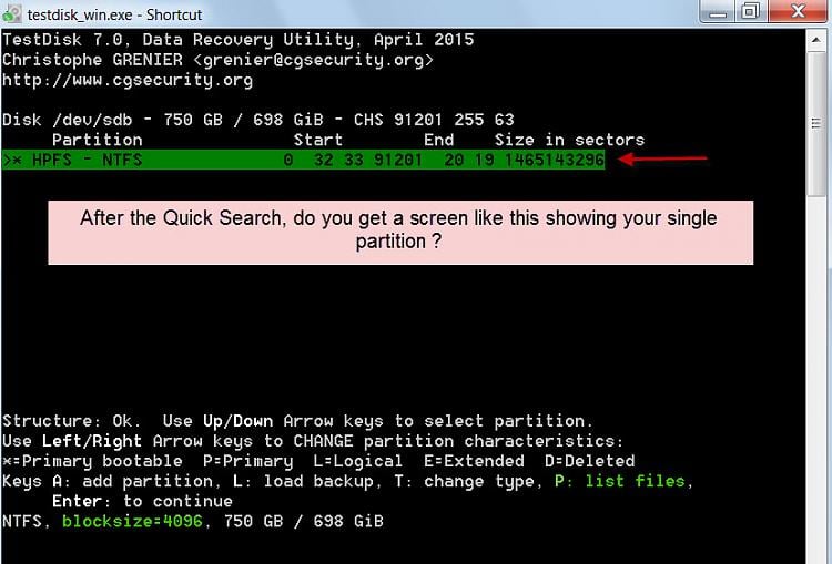

    If your only partition is shown and you get " Structure OK, blah ...blah....", highlight that partition and press P (Shift+ P ) (Capital P) to list the files. Post a screenshot.
    If your files are listed, you can select those and copy to your 2TB Destination disk into the Recovery folder . If that drive letter is say I: then your destination to copy the files will be Directory I: \ Recovery ( Replace I with the actual drive letter of your 2TB Destination drive you noted in the second screen)
    How to copy files listed by TestDisk:
    Please read my post #28 here https://www.sevenforums.com/hardware...ml#post2395385
    (Note:Screenshot 5 onwards where the files are listed applies here. Ignore the first four screenshots in that post.)
    At any point during the recovery process, if you have any doubts, post a screenshot and ask for clarification.
    jumanji, Sep 4, 2024
