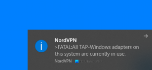

    All TAP-Windows adapters on this system are currently in use
    WinClub, Aug 30, 2020
  2. Uninstall TAP Windows Adapter V9
    SOLVED
    • Step 1: Download OpenVPN and install with ALL features from HERE : Community Downloads | OpenVPN
    • Step 2: Open CMD.exe as administrator and go to the file location of "C:\Program Files\OpenVPN\bin" or whatever that turns out to be.
    • Step 3: Follow the "Installing and uninstalling TAP-drivers" section from the website
      HERE
      : https://community.openvpn.net/openvpn/wiki/ManagingWindowsTAPDrivers
    • OR JUST READ BELOW
    • Step 4: How to get the <id> for the next section:
      • Go to Network Connections
      • Right click the TAP device you want to remove
      • Click Properties
      • Click Details
      • Using the drop-down menu, get the Hardware ID
        • This is usually something like: tapoes, tap0901 etc
    • Step 5: Remove those suckers by typing the following into CMD: tapinstall.exe remove (ID from step 4)
      • it should look something like this below:
    • Step 6: If you have devices that were not removed, repeat Steps 4-5 for all TAP adapters
    • Step 7: Restart!
    • Step 8: Uninstall OpenVPN and you're all set!
