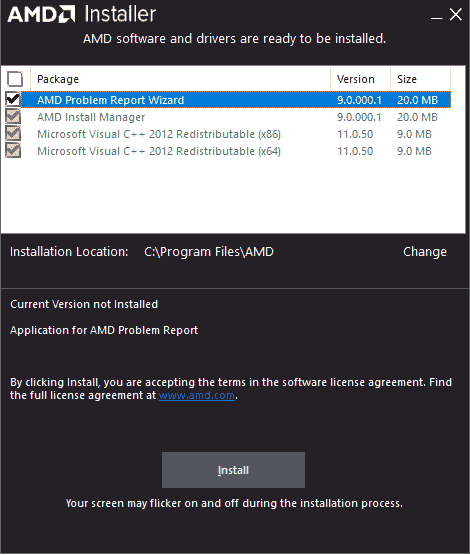

    Hello Guys,
    It's been more than a month since I upgraded to Windows 10 and I had no issues at all. After a month, all of a sudden my PC fan started making loud noise and I did try controlling through Vaio Control Center and yet no changes. Finally I happen to see that my dedicated graphic (AMD Radeon HD 7600M) were not listed in the device manager except for the Intel HD Graphics. I tried installing AMD graphics couple of times yet no changes. I downgraded to Windows 7 and still the same problem. Again I did install a fresh Windows 10 and still the same. I had tried with ample of software for detecting the hardware so I could install a driver but none displayed except for the Intel HD Graphics.
    On installation of AMD catalyst or Crimson Edition I just get the option to install "AMD Problem Report Wizard". PFA for the attached screenshot.
    Specs:
    Sony Vaio SVE14A15FN
    Intel Core i5 2450M
    RAM: 12GB
    ROM: 120GB SSD
    Display Adaptor : Intel HD Graphics 3000
    Dedicated Graphics: AMD Radeon HD 7600M (1GB)
    Monitor: 1600*900
    OS : Windows 10 Pro
    AMD Radeon HD7600M not dectecting anymore. d035b9c2-5c50-486e-bd4a-c83349ec4d3b?upload=true.png
    I would be really grateful to you all. I've wasted 3 days now and yet no success. Please help me AMD Radeon HD7600M not dectecting anymore. :(
    Thanks in advance.
