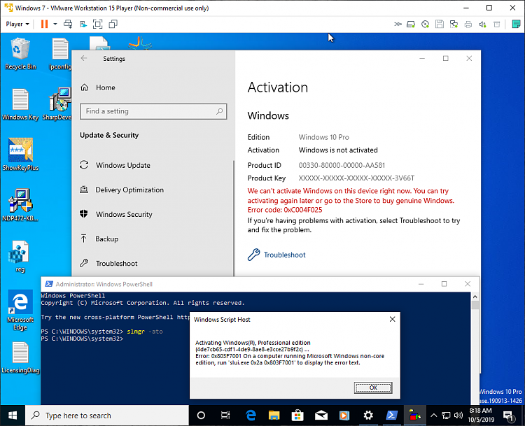

    OK I did the test
    From OEM (bios) activated Win 7 Pro VM (to emulate a notebook) - I de-activated it by uninstalling the product key
    • Turned off networking
    • Upgraded to Win 10 Pro ( it asked for a key and wouldn't accept the generic Win 10 retail key - it did accept a Win 10 MAK)
    Once installed
    • Ran slmgr /ato and got this - as expected
    an activated win 7 I upgraded to win 10. it does not like the key 250126d1570259194t-activation-problem-after-upgrading-win-7-win-10-a-capture3.png

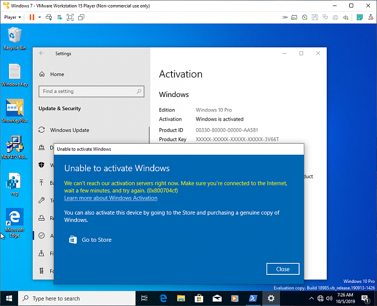

    Then went to Change Product key and entered the generic and got this:
    an activated win 7 I upgraded to win 10. it does not like the key 250127d1570259234t-activation-problem-after-upgrading-win-7-win-10-a-capture4.png
    So it activated locally providing DL but with this in the diag report

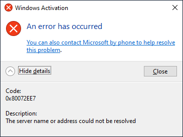

    So we are in grace/notication period but activated
    Pertinent error as noted above being
    an activated win 7 I upgraded to win 10. it does not like the key 250134d1570259763t-activation-problem-after-upgrading-win-7-win-10-a-capture10.png

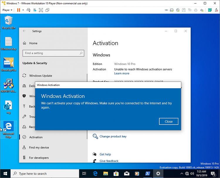

    Then with WAN established it deactivated
    an activated win 7 I upgraded to win 10. it does not like the key 250128d1570259530t-activation-problem-after-upgrading-win-7-win-10-a-capture6.png

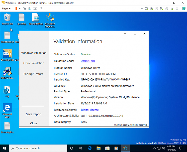

    I had to change product key again to a Win 7 OEM COA key and it then activated with a generic Win 10 OEM digital licence
    an activated win 7 I upgraded to win 10. it does not like the key 250135d1570259951t-activation-problem-after-upgrading-win-7-win-10-a-capture11.png
    Conclusion... network access is the root cause of the error (as it says on the tin) so that's what has to be established...
