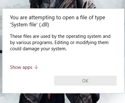

    For the past couple of days, I am getting an error message every time I switch on my Laptop. It says: "you are attempting to open a file of type 'system file' (.dll)".
    An error message about attempting to open file of type 'System File' .dll 093e53a3-32f5-4df9-bbb7-d5b7dcfcf873?upload=true.png

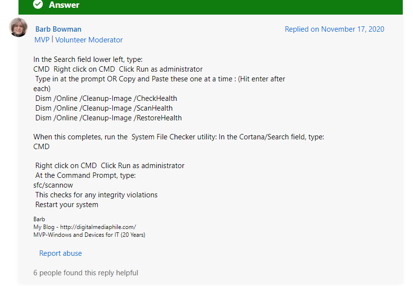

    I looked up the solution on Google and I came across this answer by Barb Bowman.
    An error message about attempting to open file of type 'System File' .dll e700e1f7-8e3c-41cb-9a3d-b659c1ff977b?upload=true.png
    I did what she said but it didn't solve my issue. How do I diagnose and fix this problem? I have not seen any other problems, but I want to make sure this is not symptomatic of a deeper problem.

    Hi Kunal16
    You are correct, that DLL is part of Jio Meet, if you do not use that, then uninstall it and see if that stops the error.
    if that does not stop the error:
    Click the link below to download a small free utility that does not require installation.
    https://download.sysinternals.com/files/Autorun...
    When the file downloads, unzip it.
    Depending on your system, run Autoruns or Autoruns64 as Administrator
    In the search box in Autoruns, type jiomeet and then right click and delete any entry found.
