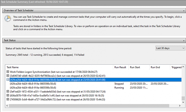

    1 The problem
    Strangely-named and seemingly inexplicable entries have been seen in the Task scheduler, Task status pane and they do not even record a Triggered by entry that would allow them to be investigated.
    I’ve taken to referring to these tasks as ‘ghost tasks’ merely as a convenience, a shorthand title.
    Annoying ghost task 283950d1592484480t-hidden-task-revealer-20200523-204108-task-scheduler-task-status-pane.png
    No corresponding task definition can be found anywhere within Task scheduler or in any of its configuration folders -C:\Windows\System32\Tasks,

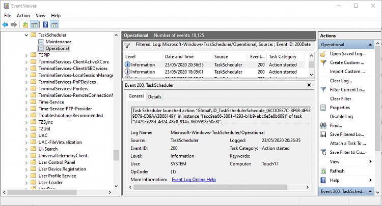

    The only other place that refers to these Task status pane entries is the Event viewer, Task scheduler log which refers to them as JD_TaskSchedulerSchedule tasks.
    Annoying ghost task 283951d1592484501t-hidden-task-revealer-20200523-203635-event-viewer-record.png
    The Task scheduler, Task status pane entry & the Event viewer entry both refer to this particular task as {429ce28d-4d24-48c8-914a-8605598c50c8}.

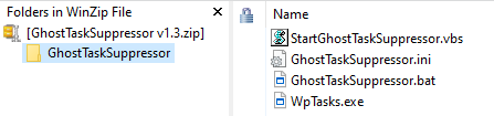

    3 Contents of the attached zip file
    GhostTaskSuppressor v1.3.zip
    Annoying ghost task 283952d1592484522t-hidden-task-revealer-contents-zip-file-root-folder.png
    Annoying ghost task 283953d1592484535t-hidden-task-revealer-contents-zip-file-subfolder.png
    GhostTaskSuppressor v1.3.pdf - This post as a pdf document.
    GhostTaskSuppressor.xml
    - A Task scheduler task definition for initiating scan, detection & deletion. This task does not need any elevated privileges. This task runs StartGhostTaskSuppressor.vbs.
    - A script that starts the batch file and allows it to run minimised & with a specific icon {so a user can recognise its taskbar entry without being interrupted by it}.
    GhostTaskSuppressor.ini
    - A text file in which the user sets preferences for use by the batch file. Using an ini file allows a user to change preferences without having to edit the batch file itself.
    GhostTaskSuppressor.bat
    - This manages the scan, detection & deletion work and makes use of Andy’s WpTasks.exe tool. This batch file does not need any elevated privileges.
    WpTasks.exe
    - This does the scan, detection & deletion. This file does not need any elevated privileges.

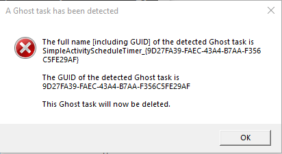

    4 Go to the line NotificationYN=YesIf you want to be told when a ghost task has been detected then leave this line as it stands.
    Annoying ghost task 283954d1592484572t-hidden-task-revealer-detection-msgbox.png
