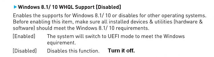

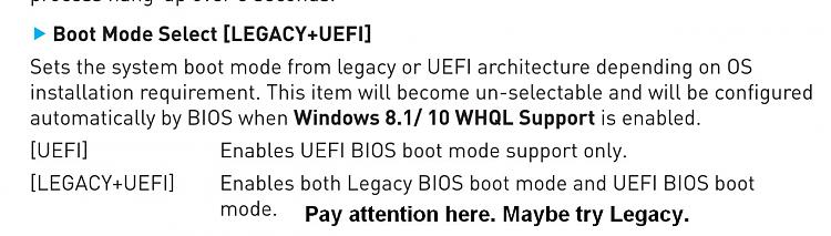

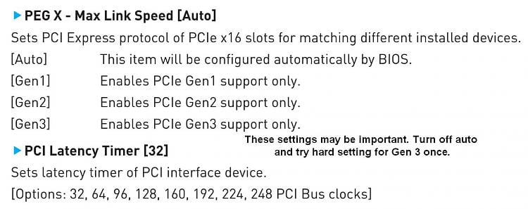

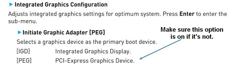

  4. Any idea about this crash error? Frequent issue
    Frequent game crashes. Driver issue ? RAM ?
    Edit- From your manual here. Make sure BIOS is using default settings and auto settings. For testing: Turn off hyper-threading. Chose two cores instead of four cores in the CPU via the BIOS setting. Turn off Execute Disable Bit. Turn off the Adjacent Cache Line Prefetch. Disable the Intel C-State. Have no idea what the CFG Lock is, but try turning it off/on for testing. Disable the EIST. Disable Intel Turbo Boost. Disconnect all peripherals except mouse and keyboard.
    Any idea about this crash error? Frequent issue 387598d1679041334t-frequent-game-crashes-driver-issue-ram-1.jpg
    Any idea about this crash error? Frequent issue 387599d1679041344t-frequent-game-crashes-driver-issue-ram-2.jpg
    Any idea about this crash error? Frequent issue 387600d1679041355t-frequent-game-crashes-driver-issue-ram-3.jpg
    Any idea about this crash error? Frequent issue 387601d1679041364t-frequent-game-crashes-driver-issue-ram-4.jpg
    F22 Simpilot, Jan 14, 2025
