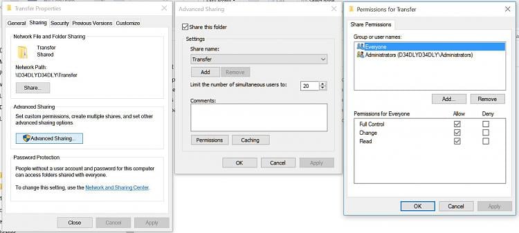

    I have a new Windows 10 Home computer and I've selected a folder and shared it. I've added Everyone to the Share Permissions list with Full Control.
    Asking for credentials to access a shared folder which i have accessed before 485956594t-win-10-pc-accessing-win-10-everyone-share-prompted-credentials-shared-folder-settings.jpg

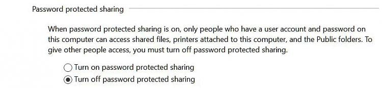

    I've selected "Turn off password protected sharing" in the Advance Sharing Center.

    When I try to access the share with a Windows 7 laptop in the home it connects right away without a prompt for credentials. When I try to access the share from another Windows 10 device (Surface) there is a prompt for credentials and I am unable to access the shared folder. There are no common account names between machines on my home network.
    On the Windows 10 machine which is trying to connect I have run Net use * /DELETE and removed all Windows Credentials using the Credentials Manager then rebooted both machines a few times. Still though the Windows 7 machine can access the share with no credentials and the Windows 10 machine can't access it at all.
    My goal is to get the share working for the Windows 10 machine as it works for the Windows 7. Full access, no prompt for credentials. I've workaround steps that will provide access so that type of information isn't needed.

  3. Win 10 PC accessing a Win 10 Everyone share prompted for credentials
    Here is the solution for this issue :
    1 Right click on the folder that you want to share
    2. Go to Properties
    3. Go to Security Tab then click Edit on group and usernames
    4. Click Add and on the user and group window click advance
    5. Click Find Now and look for Everyone on the Search results, Click OK to close the window and OK again
    6. Give the control you need for Everyone and click "OK"
    That should make that folder accessible without prompting for windows credentials Asking for credentials to access a shared folder which i have accessed before :)
