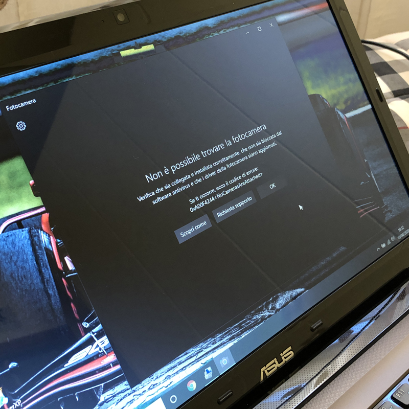

    I did exactly what you said, but when I install the Azurewave 5.8.54000.205 driver, this is what happens:
    Windows 10 generic webcam driver works, but the picture is upside down.
    I read that this happens because Asus phisically installed the webcam upside down in some of its laptops, and then the driver "fixed" this by flipping the picture, but unfortunately it seems that W7 x64 driver is not compatible with W10.
    And of course the generic one doesn't know that the camera is installed upside down.
    Asus should do something about it, probably it would be very easy for them to release a new driver, but I doubt they will since this model is a few years old now. *Sad

    To be completely clear, I still had to install the Windows 7 x64 driver from Asus website.
    With that driver, the camera doesn't work (as we seen before) in Microsoft Store apps (like Camera and Skype) but it works perfectly on "desktop" Skype.
    With the generic Windows 10 driver, the camera was upside down also on desktop Skype.
