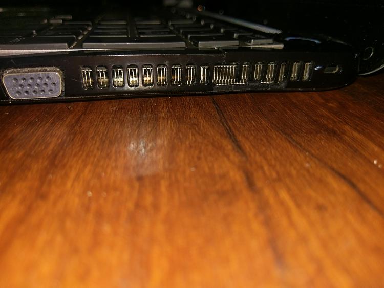

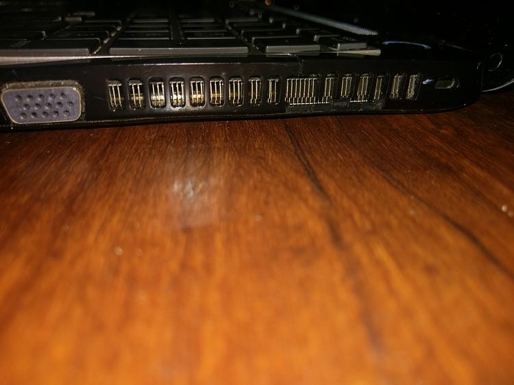

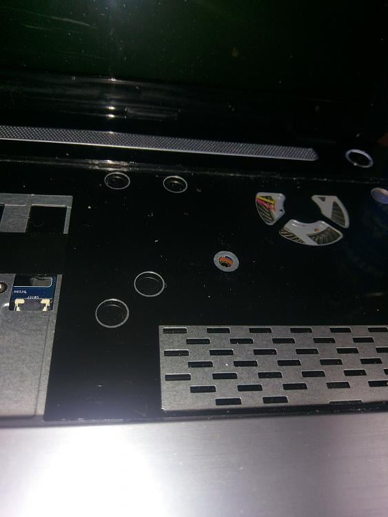

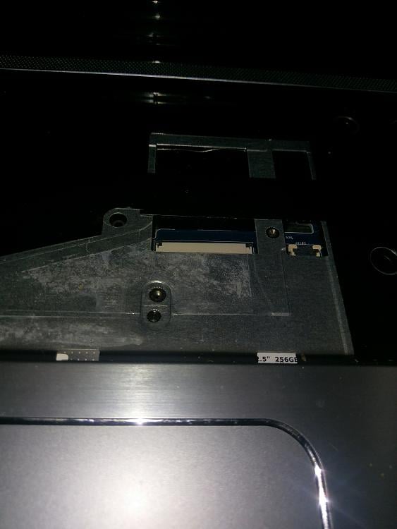

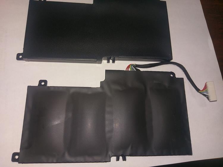

    Try again with the pictures... I also included other pictures of the damage the heat has done to the plastic chassis of the laptop. Over the years the heat has become so extreme that bits of plastic around the exhaust grill has melted or chipped off. Also, you can see how the underside of the keyboard takes the brunt of the heat from the CPU fan and battery which sits just underneath the keyboard wires (in fact just a bit of tape separates the keyboard flat cable and the swollen battery.

    Well, just now I tried another tactic. I remember I bought some memory from eBay to push my the capacity form 8gb to 16gb last year and they have worked flawlessly. But I just now put the original 8gb back in to see if its the memory that's causing the weirdness. Although as I've said in my experience failing memory usually gives BSOD, random lockups and hang etc. I'd be surprised how a memory could affect a laptop keyboard in this way but it could be the reason why I was getting problems at boot...
    The problem usually shows itself when the laptop has to restart from a cold boot so I'm going to now do a series of a cold boot to see if the issues comes back. If not then ill put the newer 16gb memory back in and do a memory test over the weekend.
    I'm starting to think the bios or the regulator that gives power to the keyboard is faulty on the mainboard. Those two issues are expensive fixes though.
