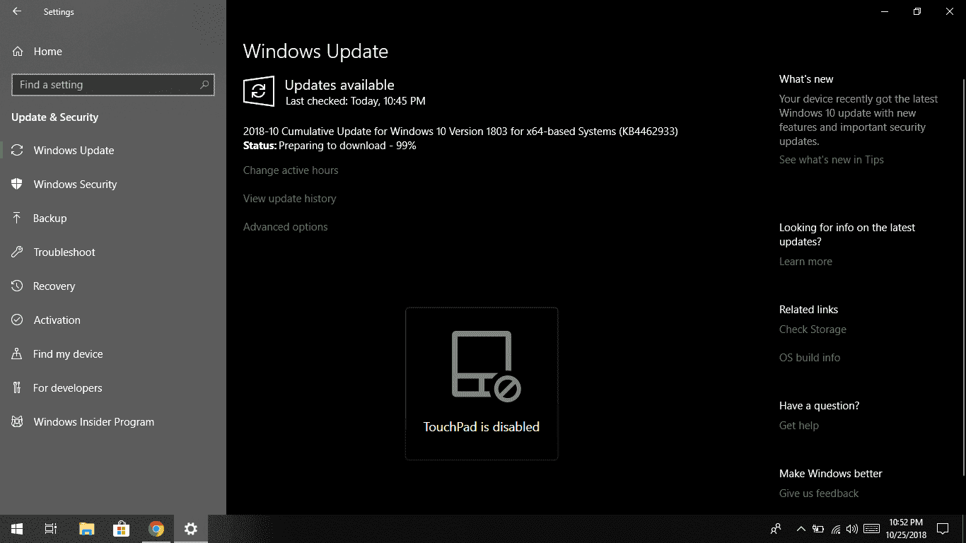

    ASUS TouchPad Suddenly Disabled fb9bd576-0380-4546-ac77-f70af9330986?upload=true.png i don't know what happened, my asus laptop using build in windows 10 and always up to date. 30 minutes ago my asus touchpad suddenly disabled is it because the cumulative update for v1803 and but not installed yet, so i shut down the laptop. when i turned it on, the touchpad was not working. i tried to pres fn+f9 to enable the touchpad but the pop up shows that the touchpad disabled and won't enable. What should i do?

    There's a possibility that you're getting this concern due to an out-dated driver. For us to better assist you, we'd like to ask a few questions:
    • Were there any recent changes prior to the issue?
    In the meantime, we suggest that you check if ASUS Touchpad is enabled on your device. To do that, you may follow these steps:
    • Type Settingson the search bar and press Enter.
    • Select Devices.
    • Click Mouse & touchpad.
    • Select Additional mouse options on the right pane.
    • Choose Device Settings (some called ELAN) pane, check Yes/No of Touchpad. If
      No, click Enable and select OK.
    Let us know how it goes.

    Hi there,
    1. Go to N501VW | ASUS Global Downloads
    2. Download the latest ATK - ATKPackage driver
    3. Download the latest TouchPad - ASUS Smart Gesture (Touchpad Driver)
    4. Uninstall both the Touchpad driver and the Asus ATK package driver.
    5. Reboot
    6. First install ATKPackage driver (IMPORTANT to do this FIRST)
    7. Reboot
    8. Then install the TouchPad driver (may need to reboot)
    9. Test if all is working as it should
    I had this same issue with my Asus UX305 when I upgraded to Windows version 1803 and doing the above steps solved the issue for me.

    Normally, you can disable the touchpad from Device Manager by follow the steps below:
    • Go to Device Manager.
    • Expand Mice and other pointing devices.
    • Right-click on HID-compliant mouse and select Disable.
    • Click Yes.
    • Check if the touchpad is already disabled.
    You can also contact the device manufacturer for further assistance if touchpad cannot be disabled.
    Update us with the outcome so we can provide further assistance.
