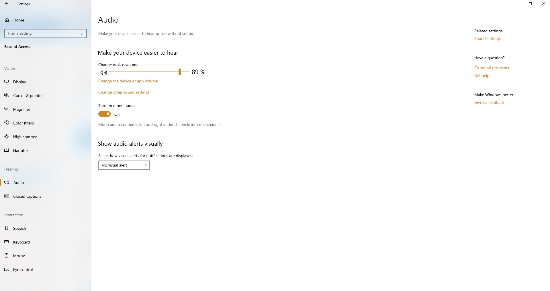

  4. Suman_B Win User
    Audio Balance doesn't work for my Bluetooth headphones - Windows 11
    Audio Balance doesn't work for my Bluetooth headphones Windows 10
    In order to get clarity and to assist you accordingly, we would need some information.
    1. May I know the Make and the model of the computer?
    2. Are you aware of any changes made on your PC before this issue occurred?
    3. Have you tried updating to latest 1903 version and check?
    Since you are able adjust the balance with other Bluetooth headphones on the same device, please
    try connecting the Skullcandy headphones on another Windows 10 device and check if the issue persist.
    Meanwhile, I suggest you to try the following methods and check:
    Method 1: Toggle the Mono settings.
    1. Go to settings.
    2. Ease of access.
    3. On the left hand side, Click on Audio
    4. Toggle the Mono audio settings
    Audio Balance doesn't work for my Bluetooth headphones - Windows 11 6fd20c65-5672-46ef-8150-dff9bf80c4e3?upload=true.jpg
    Method 2. Uninstall Ghost drivers.
    1. Select Start .
    2. In the search box on the taskbar, type device manager.
    3. Click on View and select click on Show hidden devices.
    4. Go to Sound devices and game controllers and expand it.
    5. Now uninstall all the greyed out devices.
    However, you may want to check with the Skullcandy support,
    as some of the headphones might have hardware limitations for changing the audio balance.
    Thanks,
    Suman.B
    Suman_B, Jan 19, 2023
