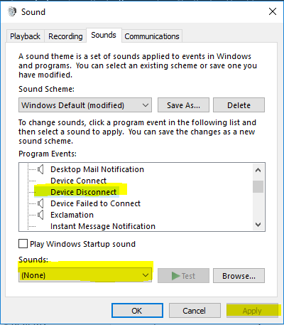

    This solution worked for me:
    I had what turned out to be a "device disconnect" sound that was repeating every minute (also when trying to play videos/audio).
    To find out which sound it was and to stop the sound I did the following: [Windows 10 Solution]
    1. Search "Sound" in the start menu or find sounds in the Control Panel
    2. Go to the "Sounds" tab.
    3. In the Program Events list, look at possible sounds it could be. One at a time, select one (ie: Device Disconnect) and change the Sounds: to '(None)'
    4. Select 'Apply'. If the sound disappears, you found the issue. If not, repeat step 3.
    Audio Issue in Windows 10. Every second of a sound is repeating 3 times d97c2380-818a-41fd-9751-c1e4d4c6b87f.png
    Please note that this is a workaround and may not be resolving the core of the issue. Hope this helps!
    Lisa-Bzy, May 9, 2024
