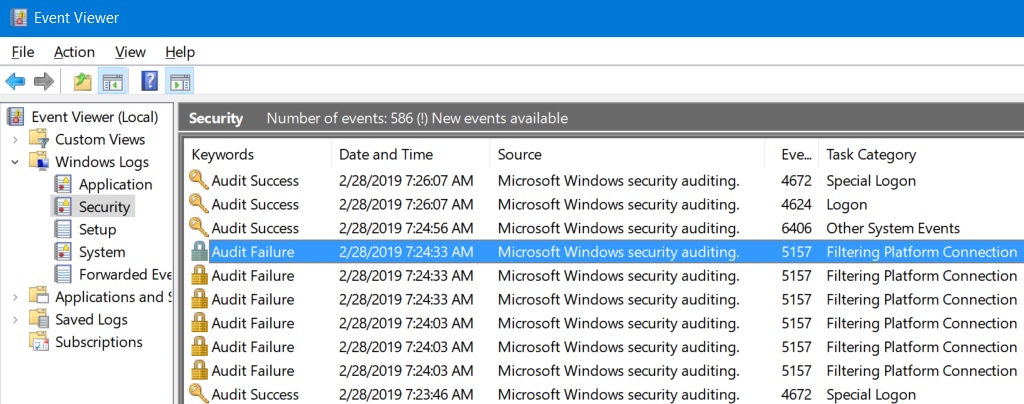

  2. Unexpected Audit Failure in Event Viewer
    Even with years of experience with Windows operating systems I am in the unenviable position of trying to diagnose an Audit Failure in the Event Viewer for Windows 10 on my Toshiba laptop that just reared its ugly head recently.
    It is perhaps noteworthy that I am not seeing the same Audit Failure on my Dell desktop. Moreover "Filtering Platform Connection" never appears. This despite the fact both computers have the same (non-hardware specific) software installed and both are
    connected problem free to my home network and printer.
    Anyone know what causes (or triggers) the Security Task Category called Filtering Platform Connection?
    Every occurrence results in an Audit Failure as shown below.
    While some may want to focus on what is causing the Filtering Platform Connection failure to occur --
    I am focusing instead on trying to figure out why I am getting the "Filtering Platform Connection" at all -- since it never appears on my desktop. But I've been wrong before. Audit Failure Windows Filtering Platform has blocked connection - Application:... :)
    Perhaps the task ""Filtering Platform Connection" only appears in the Event Viewer if there is an Audit Failure.
    Audit Failure Windows Filtering Platform has blocked connection - Application:... c64b83b8-8700-414d-87e5-d2a10e5ed7c4?upload=true.jpg
    sdmike1974, Dec 6, 2023
  3. Unexpected Audit Failure in Event Viewer
    I did make some progress in that I can disable the Audit Failure from being logged with the Event Viewer.
    Go to Command Promp (Admin) and enter:
    auditpol /set /subcategory:”Filtering Platform Connection” /success:disable /failure:disable
    Caveat: Someone posted that the Audit Failure will likely return the next day.
    Plus this is tantamount to replacing a fuse without fixing the underlying problem which is causing the fuse to blow.
    Still hoping an Event Viewer / "Filtering Platform Connection" guru will chime in.
