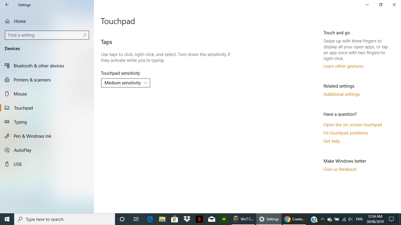

    My Windows 10 Laptop used to automatically disable the touchpad when I connected a USB mouse. This has stopped working after a windows update & the tick box to disable the touchpad has disappeared from settings.
    Auto disable touchpad when usb mouse connected issue. No auto disable tick box in settings. 8c09b779-b4f5-4ca8-9642-848fb9b6b514?upload=true.png

    F3 or F9 keys, but that depends on the laptop that you have. Each brand have its own shortcut keys. However, you can disable the touchpad from the Settings page. Follow these steps:
    1. Open Settings > Devices.
    2. In the left pane, click Touchpad.
    3. To completely disable the touchpad, toggle off Touchpad.
    4. If you only want to disable the touchpad when an external mouse is connected, check the box for
      Leave touchpad on when a mouse is connected option.
    Let me know if you need further help so I can assist you.
