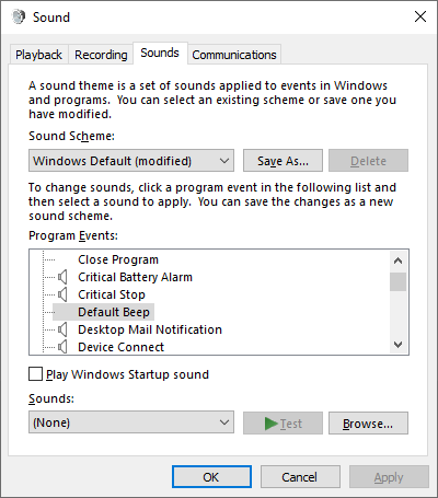

    As far as I know, the only way to disable the volume slider sound is to set "Default Beep" to None. But "Default Beep" is also used by other events; it's not exclusive to the volume slider.
    Right-click Start, click Run.
    Type mmsys.cpl and click OK.
    Click on the Sounds tab.
    Set "Default Beep" to None.
    Avoid "bong" when adjusting the volume slider on Windows 10 4013dc95-01b0-414e-bcc0-2dba19ae1873?upload=true.png
    Ramesh Srinivasan, Mar 9, 2023
