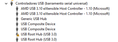

    Hello, I've have been facing an issue with windows 10 that makes all USB 3.0/3.1 ports don't work no matter what driver I install. But everything works fine on Linux or in the Bios. And all USB 2.0, USB-C and USB 3.2 Gen 2 works normally.
    Tried to instal AMD chipset drivers from the motherboard website and directly from AMD, nothing. The usb 3.0 ports stop working as soon the windows installation boots, so drivers aren't the issue?
    Windows 10 Pro 20H2 I've tested with 1909 and 2004 also
    Setup:
    Ryzen 3100
    Motherboards I tested: B450m & B550m Steel Legend, Asus Tuf B550m plus
    Rx 580
    8gb HyperX 2400mhz ram
    I've tested with 3 B550m Steel Legend motherboards, different ryzen processors, different power suply and ram. Not a single hardware problem, I did contact the store I bought the motherboard and ASRock for help, but they did very basic checks and replaced my motherboard with new ones Right now this is the third b550 steel legend from replacement.
    Could someone help me here?
    Starts like this:
    B450, B550 USB 3.0/3.1 don't work on Windows 10 2354d5ed-76c6-4897-a151-8d7ea775c905?upload=true.png

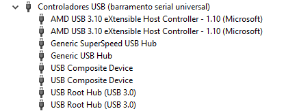

    Some seconds after inserting anything on a usb 3.0 port:
    B450, B550 USB 3.0/3.1 don't work on Windows 10 ce76e5cf-a0b7-4d37-82a7-57398b5ff34c?upload=true.png
