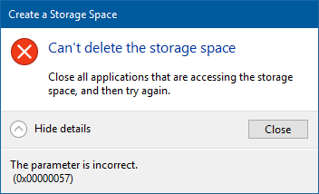

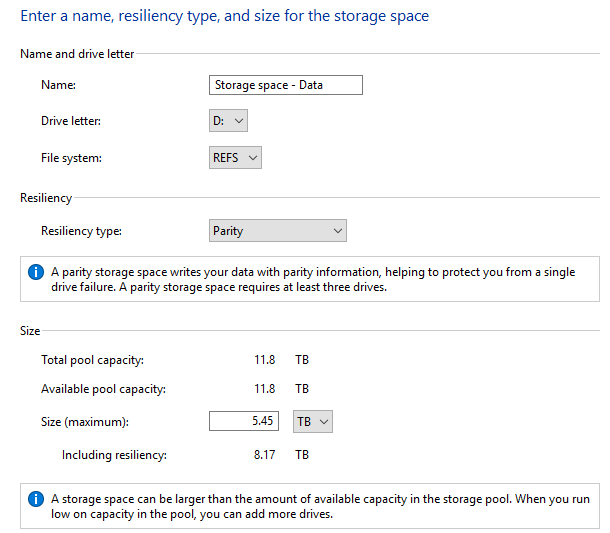

    I just encountered a failure. Following is my setup using three drives (1-3TB, 1-4TB, 1-6TB)
    Back  Up Windows 10 Storage Spaces Configuration 5c4705c3-c056-4b8a-a34b-668295911503.png
    Following is my failure, in the above image I had clicked the "Create storage space" button, a window pops up "Creating storage space" and quickly changes to "Formatting Storage space" for about 10-20 seconds, then changes to "Deleting Storage space" and
    then to "Can't delete the storage space". I'm tired and I'm giving up for tonight.
    Back  Up Windows 10 Storage Spaces Configuration f92e9132-26e1-4b23-8b6c-4baa976dc5f9.png
    Ops forgot to mention. I was able to create a mirror but not a three way mirror or not the Parity (this is what I want).

    • With my first attempts I was NOT able to create a Storage Space. As I research the issue I discovered one post that stated I could NOT have either a software or hardware RAID on the same system. At this time I did have the “LSI SAS9211-8I 8 Port” card installed.
      I’ve discovered that the card was set as a RAID card. At that time I was NOT able to get into the card BIOS and change any of the settings or software, thus I removed the card.
    • After removing the card I was able to create the Storage Space but this was not without discover of another issue. I wanted to use Parity which is like RAID 5 and I also wanted to use the ReFS file format. Initially because of my choices (Parity and ReFS)
      I could NOT create the Storage Space and discovered that MS does not support this combination but in the setup they allow you to select Parity and ReFS To resolve the issue I picked Parity and NTFS, this allowed me to create the Storage Space.
    • Another challenge was setting the value for maximum size for the storage space. As I understand it is best to establish a huge max size thus as you add more disk you do not hit the max size limit. If you hit the max size limit then it will be necessary
      to create a new storage space with a huge max size, move the contents of the first storage space to the new storage space. This would be super time consuming and require a lot of hard drives as temp holding space. After many attempts I settled on a max size
      of 50TB and with the three drives, 1-3TB, 1-4TB, 1-6TB, I had a space with 11.8TB and a max size of 50TB. This should be more than enough space for my data for the living years I have left remaining.
