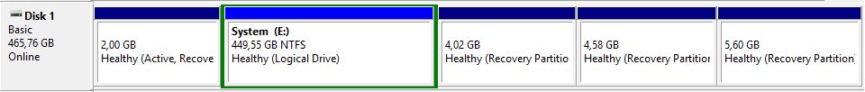

    I have a computer that cannot boot into Windows 10 just get Bad_System_Config_Info and using automatic repair don't work, using bootrec /fixmbr, bootrec /rebuildbcd, bootrec /fixboot (not allowed) don't work and i did some more advanced stuff too didn't work.
    I can see when i connect the disk to usb, it has 3 recovery partitions:
    Since I can't boot into Windows it's not possible to do a upgrade so that's out of the question.
    I know there is a way to do a normal installation to keep user profile, settings, applications and files I done that once before but I can't remember how, is there a friendly soul that has a link or something for this?
