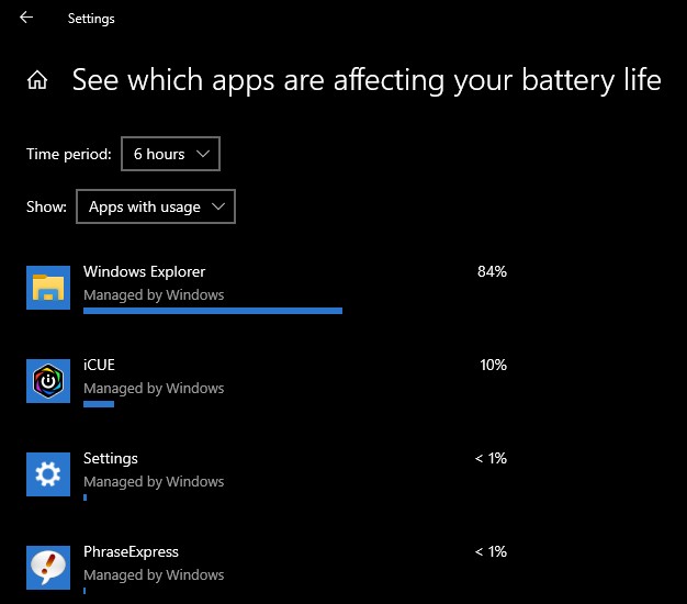

    I checked windows settings > system > battery > "See which apps are affecting your battery life". That says Windows Explorer consumed 84% of the battery!!
    Battery draining 1% per minute. powercfg /spr shows "Unkonwn [None]" consumed almost all of... 8e8b0217-5b68-4998-89bc-e855057819b6?upload=true.jpg

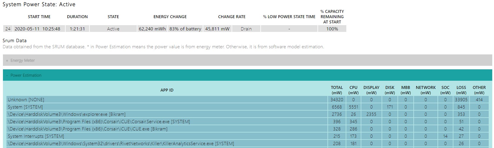

    I then ran powercfg /spr and the generated report shows Explorer is only the 3rd highest consumer. Some "Unknown [NONE]" app has drained most of the battery and most of it went in "Loss".
    Battery draining 1% per minute. powercfg /spr shows "Unkonwn [None]" consumed almost all of... c86bf7ff-3e20-430a-ba56-c105eb5a99da?upload=true.jpg

    Powercfg /sleepstudy report shows "Unknown [NONE]" appid which consumes more power
