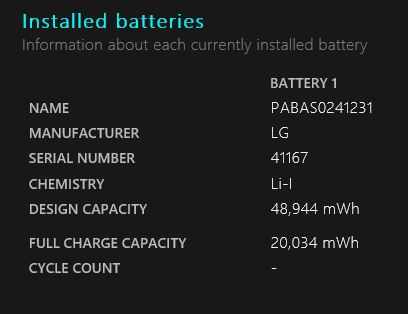

    I have Acer Nitro 5 AN515-52 laptop running 64 bit windows 10 version 21H1 (OS Build 19043.1165)I am facing an unusual battery drain to sudden 0. This began happening yesterday and happened again today. I suppose the battery drops to zero from 50-60%. There's no warning. The laptop just closes all of a sudden.Every time I work with my laptop plugged in the wall charging. I don't turn off the charging even it's full and continue to use it as it is. I only use my laptop on battery when I'm commuting, and that's exactly when I have faced this issue. I bought this laptop in April 2019. I'm enclosing the battery report html as a zip generated using Windows Powershell. Please suggest a solution.

    Battery level suddendly drops from 80% to zero 343446d1628946113t-sudden-battery-drop-zero-key-results.jpg
    If you had run a battery report when the battery was brand new, you would have seen its Full charge capacity matching its Design capacity. That ratio reduces as the battery gets used. Yours is currently 20034/48944 ≅ 40%
    There's no generally-applicable magic number at which the battery is deemed to be too worn out for further use. In your case I think you'd make your decision based on time rather than charge level - it would be when the battery did not last the whole of your journey.
    Denis
