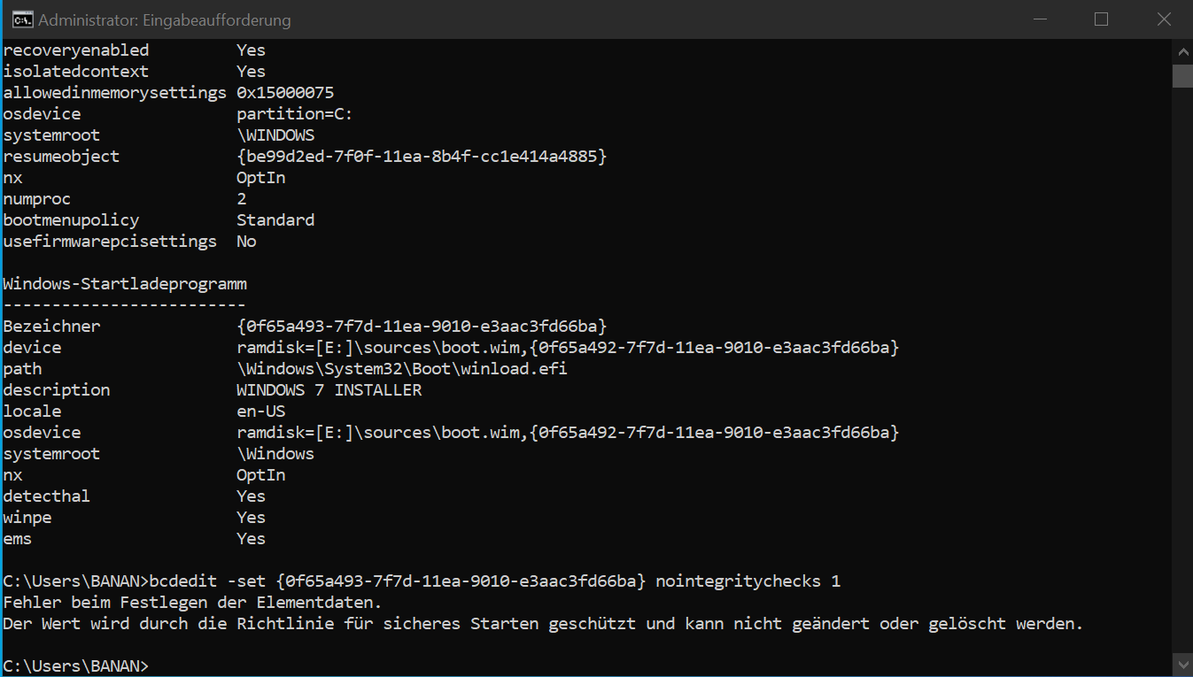

Discus and support bcdedit in Windows 10 Installation and Upgrade to solve the problem; Wieso geht es nicht? [ATTACH] https://answers.microsoft.com/en-us/windows/forum/all/bcdedit/38c75434-6d8f-4753-b7f1-4ecd6fd21992 Discussion in 'Windows 10 Installation and Upgrade' started by SchwarzWeiß1, Apr 15, 2020.
  1. bcdedit
    Wieso geht es nicht? bcdedit 2eedcc60-f1c4-4d24-9c75-dc4194ec3c8c?upload=true.png

  3. Saltgrass Win User
    Disabled Hyper-V using BCDedit
    It looks to me like you have set the default boot entry 7f416673-xxxxxx. I will assume, for now the correct default boot entry should be
    7f416671-xxxxx.
    If you agree this may be the case then there is a bcdedit command to change the default boot loader.
    Try using the command below to see how it looks. Be aware, the Guid numbers can be copied and pasted. If you type bcdedit first, you can copy those from that listing.
    bcdedit /default /?
    Examples:
    The following command sets the specified entry as the default boot manager
    entry:
    bcdedit /default {7f416671-8242-11e9-952c-f625ea39d281}
    Use the correct GUID for your system..
    One problem bcdedit has right now is we can no longer use the command bcdedit /enum which would show all the entries in the store. This is why the 7f416673-xxx is not showing in the list.
    Note: There is a possibility the Recovery Tools were set as the default boot on purpose. If your system will not boot with the 7f416671 number you might try the 7f416675 GUID number, or even try that one first since it shows as no Hyper.
