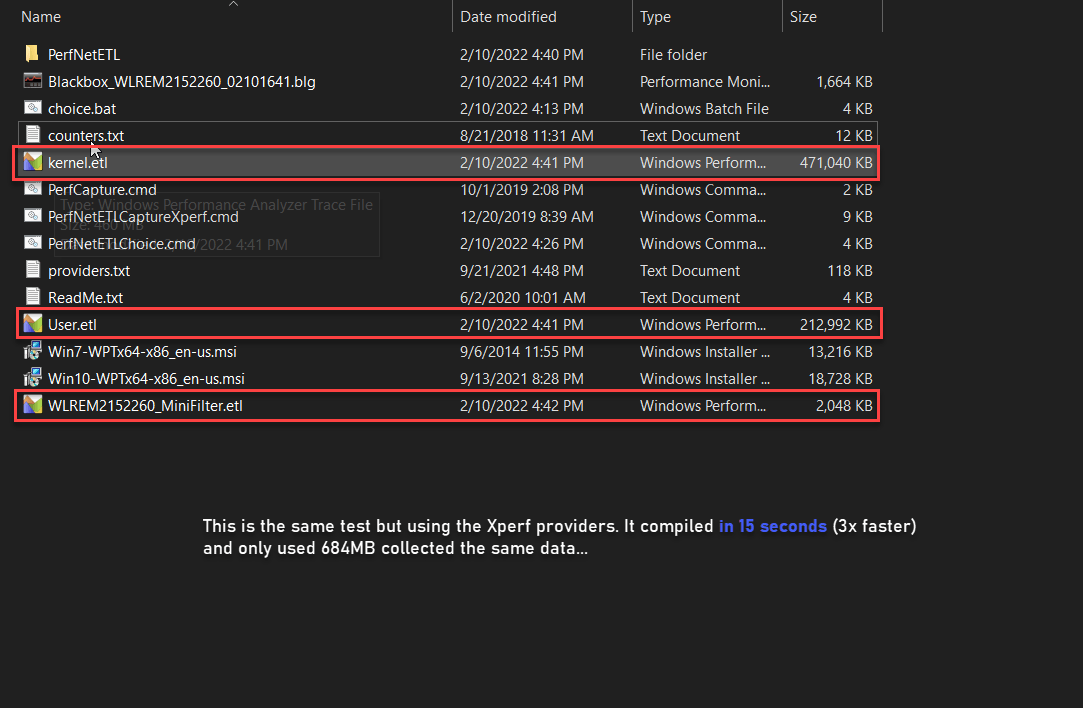

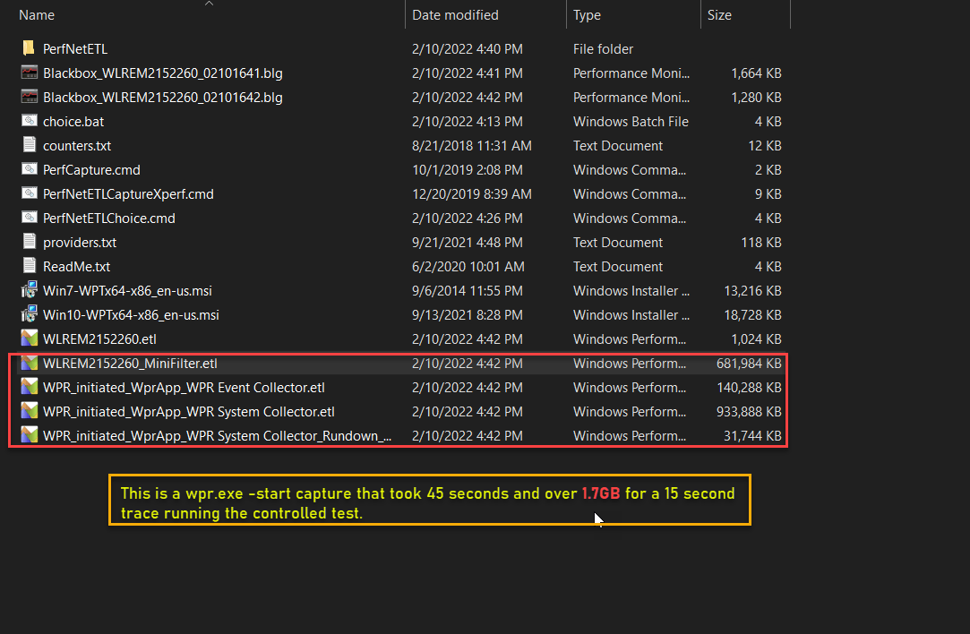

    Screenshots:
    Observe that Xperf compiled on my system 3x faster and only used 648MB vs. 1.7GB for the exact same data in WPR. Why the resource and file bloat to use WPR?
    Best method to setup 4 disk's 2x NMVE.2 and 2x HDD Disk's de3d0e67-c57f-4b51-b6e2-39bde474ed44?upload=true.png
    Best method to setup 4 disk's 2x NMVE.2 and 2x HDD Disk's bf52f651-b37b-4f9b-bee0-4b8df49412e6?upload=true.png
    Shane Creamer, Jul 9, 2024
