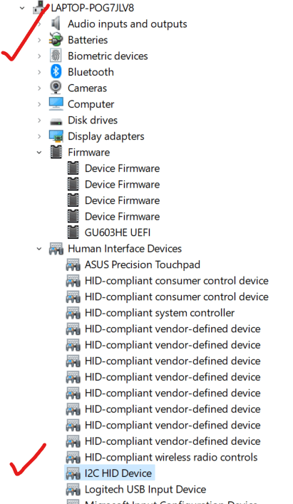

    Thanks for the reply. You are absolutely correct in your solution. One difference in my case.
    When Windows 11 Upgrade broke my system, it removed the Biometric Devices entry so I could not find the correct driver to un/reinstall. I had to go through every logical driver entry until I found the correct one. It is shown in the png file here.
    I had to un/reinstall the I2C HID device before the Biometric Device could be seen.
    I've worked with Windows since Version 1 and it came 2 or 3 2SHD (1.2MB) Floppies. I used to manage a software store - Software Etc. My point is that Microsoft never ceases to amaze me in how they can break simple things. But to their credit, they are doing some complex things that have to work in Billions (literally) of different environments.
