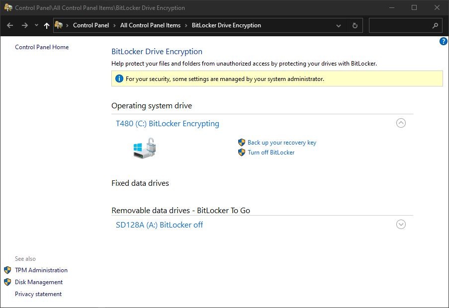

  3. icelava Win User
    BitLocker cannot encrypt secondary fixed drive
    I have a Lenovo ThinkPad T480 with two NVMe SSDs. Both have been encrypted with BitLocker for years.
    Recently I had to send the laptop for repairs and they replaced the motherboard and reset the device and thus the drives. Once I got it back, I restored the drives from my Acronis True Image 2020 backup images. The OS booted back to its original state before the hardware repair. Unsurprisingly, the drives lost their encrypted state.
    When attempting to re-encrypt the system drive, BitLocker threw an error "The system cannot find the file specified." I learnt that the file C:\Windows\System32\Recovery\ReAgent.xml may be corrupt and needs to be deleted. I found and renamed the files
    • C:\Windows\System32\Recovery\ReAgent.xml
    • C:\Windows\System32\Recovery\ReAgent_Merged.xml1
    and was able to get BitLocker to commence encrypting the system drive again.
    However, there's another problem - the secondary drive D: is missing from the Fixed data drives list.
    Bitlocker on secondary drive after installing new drive 8b712787-302c-40ff-9000-c6b5187b1f66?upload=true.jpg
    Neither can I right-click on it to initiate BitLocker from Windows Explorer context menu.
    What should I do to get the system to re-recognise my secondary drive?
    icelava, Dec 19, 2023
  4. icelava Win User
    So it seems when I was performing the restoration procedure, the secondary drive partition got marked as active. Looks like Windows does not like other active partitions that weren't used to boot the OS, and won't treat them as "fixed data drives".
    After marking the secondary drive partition as inactive (with diskpart) and a restart, Windows/BitLocker finally acknowledges the secondary drive and can commence with encryption.
