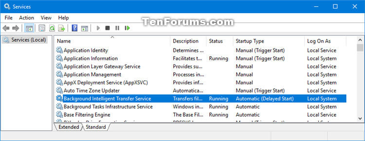

    BITS service manual or automatic?
    Hello shadowblade, BITS service is stopping and going to manual :)
    This below is the default setting for the BITS service, so it's fine to leave it on "Automatic".
    BITS service is stopping and going to manual 127049d1490741349t-bits-service-manual-automatic-bits.png
    Brink, Feb 20, 2023
