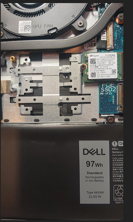

    Hi I'm getting a new second drive and would appreciate step by step instructions. I never done this before so I will provide a picture of my laptop . this drive is a 1tb. It's double the size of what I have and apparently faster. I would like to use the new drive as C drive and the second drive as a documents drive. All comments or instruction will be greatly appreciated. Thank you
    Bluescreen after installing a second m.2 345830d1631382782t-installing-second-nvm-2-drive-screenshot-334-.png
    Bluescreen after installing a second m.2 345831d1631382818t-installing-second-nvm-2-drive-screenshot-333-.png
    vicf1, Jan 19, 2025
