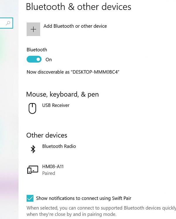

    Hello, about an hour ago, my wireless earbuds stopped any audio. I tried fixing the problem by troubleshooting, and when I tried to reconnect the earbuds, it stated that the earbuds needed to be found via Bluetooth, but my earbuds were ready to pair and were able to be Bluetooth connected to my phone. I shut down my Microsoft Surface Pro 7 twice still with no avail. I also tried another pair of wireless earbuds and still nothing.I tried stopping and starting my Bluetooth services, and while the last two worked, Bluetooth Audio Gateway didn't and is now on "Stopping" even after various refreshe

  4. Bluetooth Audio Gateway Service continues to stay stopping while trying to get my earbuds...
    Bluetooth Earbuds not working
    Bluetooth Audio Gateway Service continues to stay stopping while trying to get my earbuds... 391601d1685481627t-bluetooth-earbuds-not-working-bluet.jpg
    halffast64, Jul 2, 2023
