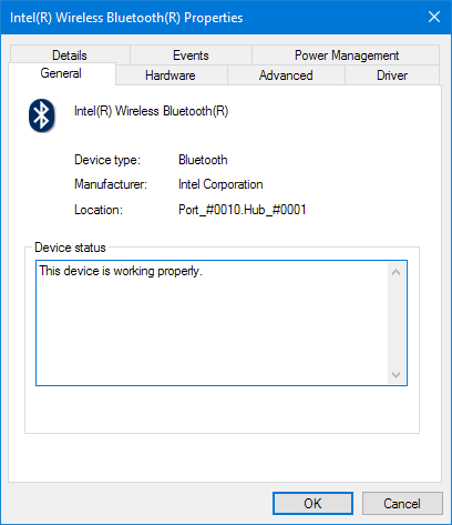

  3. JoeDuarte Win User
    "Bluetooth Settings" is missing and not showing
    Hi Antonio – I had the same issue last week and fixed it. Forget about Services settings or the Programs list in Control Panel.
    1. Open Device Manager (right-click on your Start button, then in the pop-up menu click on Device Manager)
    2. In Device Manager, double-click on Bluetooth – it's the second item listed, right after Audio Inputs...
    3. Now you'll see a list of items under Bluetooth. Your Bluetooth adapter/card will be in this list, and its name will be company that makes it. e.g. Intel Wireless Bluetooth. Ignore the other items listed under Bluetooth, the Microsoft stuff and any Bluetooth devices that you see in the list, like mice or headphones. If you don't know who makes your Bluetooth card, this info will be in your paperwork, and on the PC-maker's website. It's often Intel, so if you see Intel Wireless Bluetooth, just double-click on it. If your supplier is different than click on them instead.
    4. Look at the initial screen that pops up. Under Device Status, it will say "The device is working properly", or is not working properly. If it says it's not working properly, open the Driver tab in this window, and click the Enable button.
    Bluetooth button missing 119926d1486299792t-bluetooth-settings-missing-not-showing-2017-02-05_05-19-07.png
    That should fix it. Might need a reboot, but I don't remember. Go into Settings --> Devices, and Bluetooth should be back.
    Later,
    Joe Duarte
