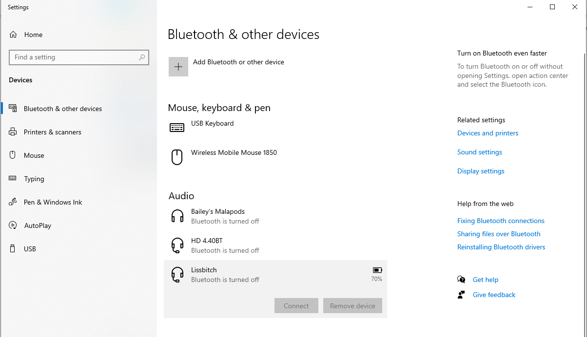

    Kia ora, My Bluetooth has been disabled, I was trying to connect some wireless headphones and somehow managed to lose the Bluetooth on/off toggle button. I have tried uninstalling bluetooth devices/drivers to find a solution but none have worked so far. Any help would be much appreciated. Bluetooth disabled 2491825a-4834-4271-8a44-7cefd1fe4575?upload=true.png

  3. Bluetooth Here but disabled
    We would be glad to help you with the issue you are facing today. I understand the difficulty with the problem.
    I suggest you to follow the methods below:
    Method 1:
    Run Hardware and Devices Troubleshooter
    Follow these steps to run Hardware and Devices troubleshooter.
    • Press “Windows key + W” and type “troubleshooting”.
    • Select “Troubleshooting”.
    • Select “View all” on the top left corner.
    • Click “Hardware and Devices”.
    • Follow the on-screen instruction to run the troubleshooter.
    Method 2:
    Uninstall and reinstall the Bluetooth driver
    I suggest you to try uninstall the Bluetooth
    drivers check if it works for you.
    Follow the steps to uninstall the Bluetooth
    drivers:
    • Press “Windows Key + X key” and click “Device Manager”.
    • Right-click on the “Bluetooth” device listed and click on ‘Uninstall’.
    • Select the option to “delete driver software”.
    • “Restart” the computer after its uninstalled.
    Try to access the device manufacturer's website and download and install the latest chipset and Bluetooth
    drivers.
    Hope this will fix the issue, if not let us know with the updated status and we will be happy to assist you further.
