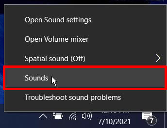

    Right-click on little speaker (bottom right on desktop)
    Bluetooth Headphones Connected, but no sound 340159d1625948100t-stereo-bluetooth-headphones-do-not-reproduce-stereo-sound-audio1.jpg
    Select Sounds from list
    Bluetooth Headphones Connected, but no sound 340162d1625948100t-stereo-bluetooth-headphones-do-not-reproduce-stereo-sound-audio5.jpg
