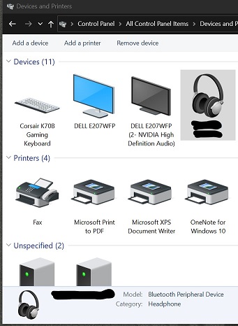

    Under "Devices and Printers", my headphones show no errors my device's name is the one very obviously blacked out:
    Bluetooth Headphones connected in Windows 10 after fresh install, but for voice and not music 6849f352-5f39-4cd7-a9fe-6849ce38f942?upload=true.jpg

    So if Device Manager and Devices and Printers show no errors, and the Properties of the device itself show the Stereo device, it should be working correctly right?
    I've tried all sorts of things, Windows Troubleshooting the device, attempts on updating drivers, and updating drivers via Windows Update have done nothing. As I've said before, I'm fully up to date running the latest possible build... I even updated my Bluetooth driver to the latest version available from my manufacturer. The Bose QC35s have been updated as well. Maybe Bose broke something in their last update? Then again.... they still work perfect on any other device....
